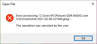

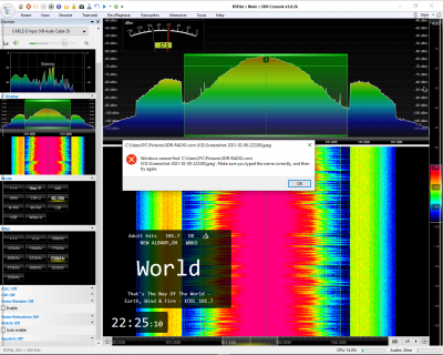

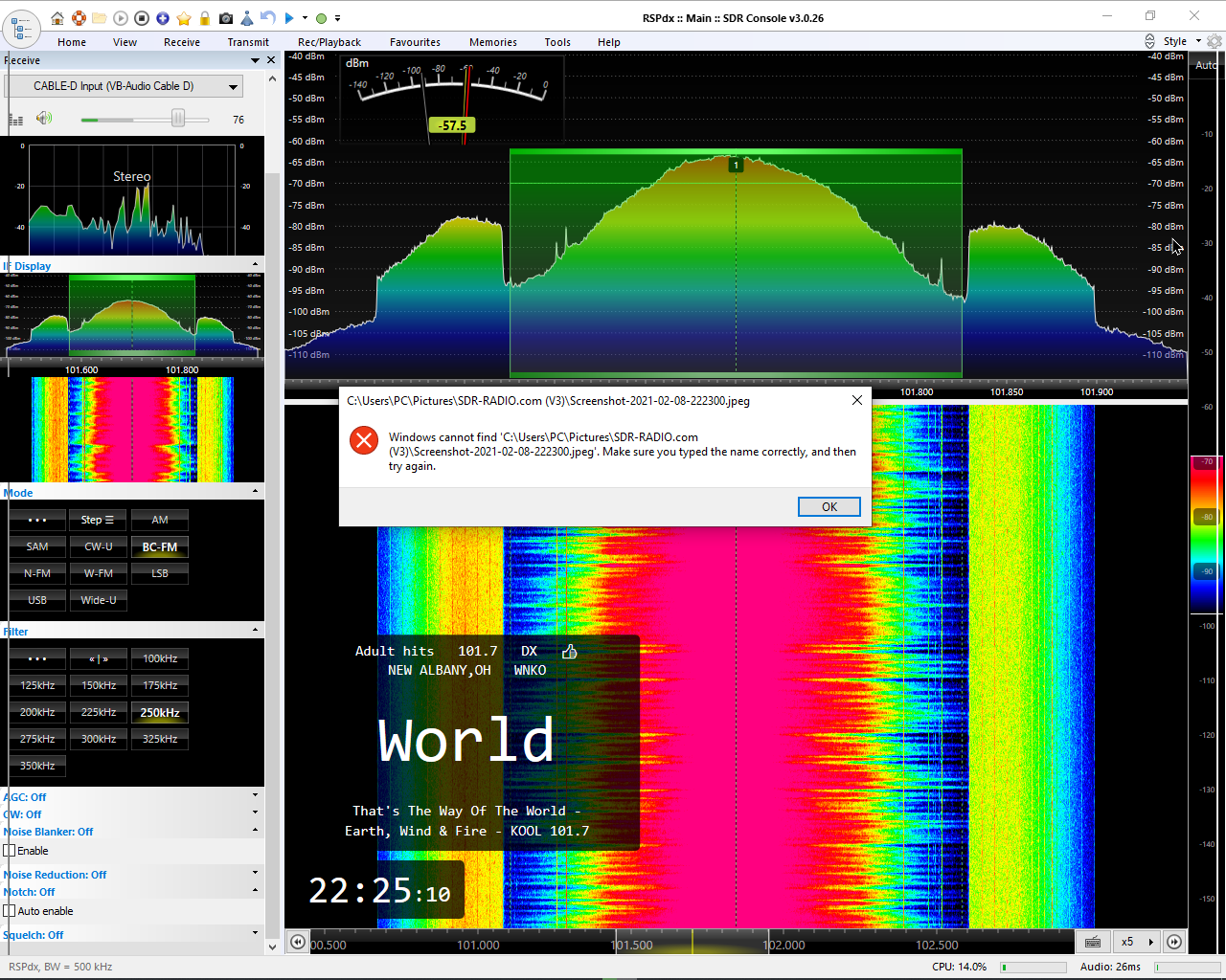

I receive an error after taking a screenshot when I select Open or Open with.... A message popup indicates: "Windows cannot find 'C:\Users\PC\Pictures\SDR-RADIO.com (V3)\Screenshot-2021-02-09-001234.jpeg' Make sure you typed the name correctly, and then try again." No file is created/saved to the "C:\Users\PC\Pictures\SDR-RADIO.com (V3)" folder. If I select Show in folder the message box just disappears.
When I upgraded to v3.0.26 (from .25), 64-bit I used a utility to completely remove all files and registry entries since the new installation still had the screenshot problem when installed. I used a fresh download and tried again but still didn't work. This is really puzzling. The folder (C:\Users\PC\Pictures\SDR-RADIO.com (V3)\) is empty and a search across the whole drive didn't show SDRC actually saved a picture anywhere.
Using SDRplay RSPdx, Microsoft Windows 10 Pro [Version 10.0.19041.746] and have had this problem since September last year.
Any suggestions would be appreciated.
Dale WB8CJW
Error processing screen capture_3.png (5.4 KiB) Viewed 3517 times

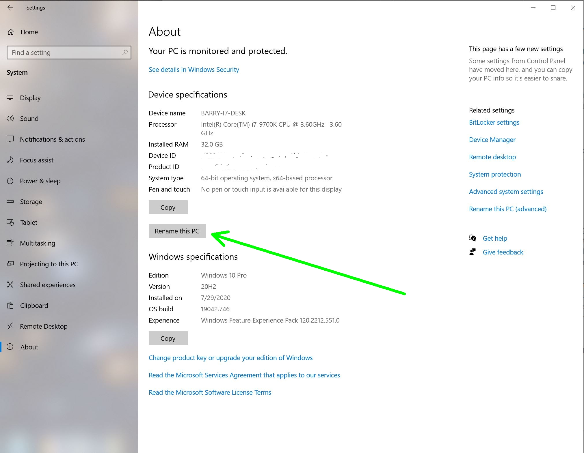

Hi Dale,
Have you tried renaming your PC?
Barry

Barry, the name that MAY be giving a problem is the username he entered during installation. That CAN be changed. It can be ugly if you have encrypted anything on the machine. It is done though the user management. You have to dig but it is there.

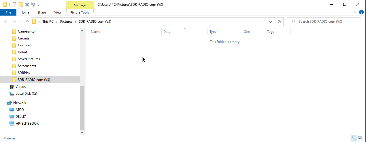

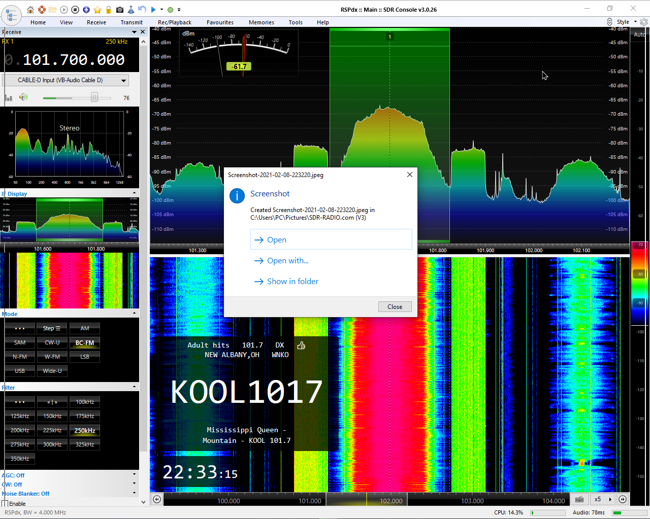

___I have deleted the folder several times. It is recreated during the installation. Remember this configuration did work at one time.
I searched the whole drive for 'Screenshot-*' - nothing. Also searched by date for anything that contains "2021-02-10" - nothing. Either the image file was not produced or an error without a notification occured - the process was simply aborted. A Windows message says "The operation was canceled by the user." That is not true...that message came along after the 'Windows cannot find ..\Screenshot xxxx.jpeg.' Then "Make sure you typed the name correctly, and then try again." There was no typing of the name involved and I didn't cancel anything. This is apparently a call to a Windows function that has a standard error message. This made me think there really may be a system problem so I did a SFC System Files Check and DISM with no errors found.

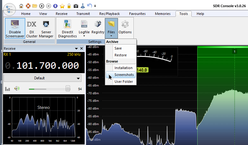

___Image 1 through 3.png shows the sequence of message boxes that pop up. Image 5 shows the alternate method of navigating to the screenshots directory. Tools >Files >Screenshots. Then Image 7 shows the empty 'C:\Users\PC\Pictures\SDR-RADIO.com (V3)' folder. (I discarded Image 4 and 6.)

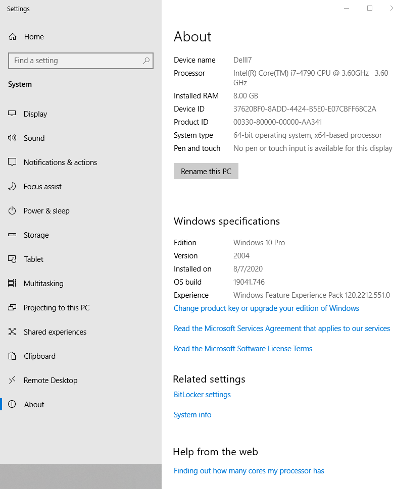

Fascinating, my About page does not have any lines below "Read the Microsoft Software License Terms". Are you using BitLocker? I wonder if THAT could be interacting with something.
And a thought just cross my mind. I wonder if an AV tool designed to block screen scraping is installed. That could do it. Some banks offer or at least offered at one time a utililty like that from Trusteer named Rapport or something like that.
