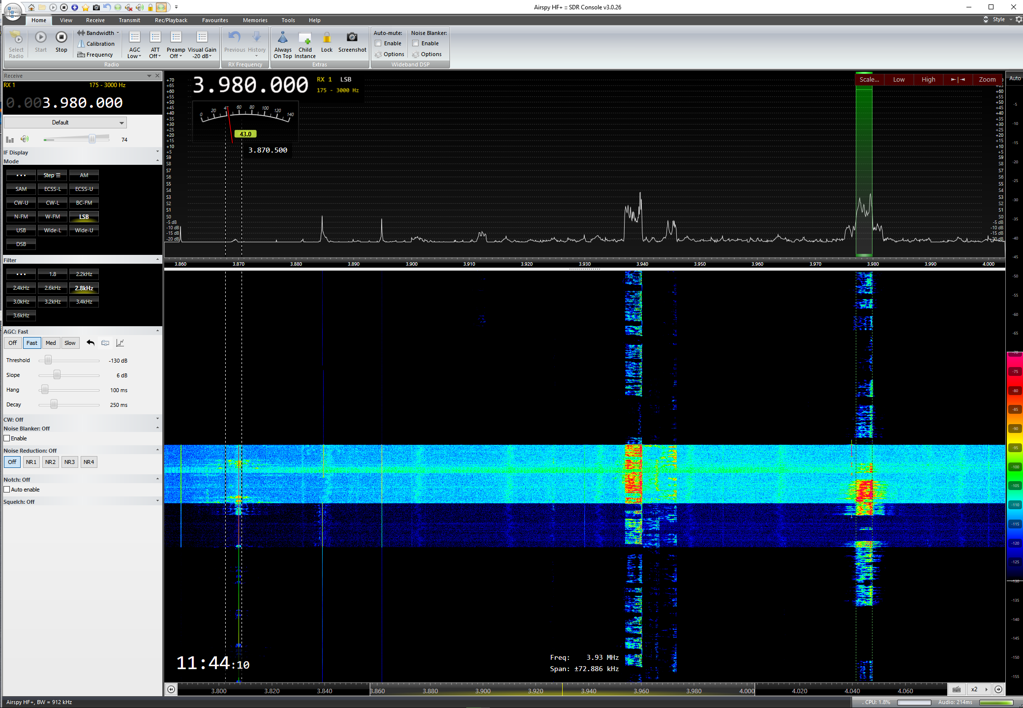

Listening to my Discovery using v3026 & getting audio clipping on LSB 80M. I have had this issue many months ago, posted the issue on the IO group & then it seemed to just disappear. When this happens the "Audio:" gage (latency??) at the bottom left of the display goes well above 100ms. There are time it gets to +350ms. This clipping does not happen with other s/w. I have tried 2 different USB ports (hub & no hub) to no avail. When the "latency" is below ~60ms, then audio is fine. Thoughts? Bob W8RMV

Do not turn the visual gain down so much. Leave it at 0.

I've tried moving the VG to every step, to no avail.
I've turned off the AGC & tried several ATT settings, to no avail.
Tried fast med & slow AGC, to no avail.
I've uninstalled & reinstalled the latest Console, to no avail.
To my ears it sounds "like" clipping distortion from a bad AGC or poor noise blanker or if the audio input is o/l the preamp in the computer.
Maybe this is normal, but when I mute the speaker on Console, Audio: is at 0ms, but I can still see audio activity on the volume control.
CPU is at <2% & Size: 523MB.
Compooter is an I7 32GB ram running W10 64bit & the very latest updates & drivers.
I've a DP HF+ & a RSP2 I may try later. But when I run SDR# the Discovery runs fine. ???
-Bob W8RMV
