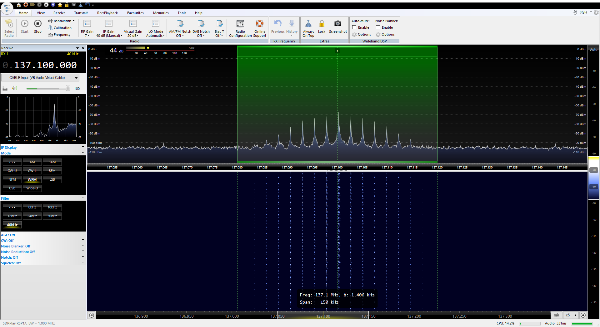

Simon:
Please see the screen shot. Meanwhile, it is working. Here's what I did. Waiting for the next pass to get your screenshot, I was watching the display, and it looked pretty good. But, I decided that there must be some reason why the WXtoIMG PLL is not locking, so I decided to listen to the signal. Therefore I changed the Audio from the VB cable to the speakers. Sounded good, no sub-tones or other detritus. So I switched back to the VB cable. Bam, the WXtoIMG PLL immediately locked. I let it run all night. OK. Turned off at 6 AM, went for my morning walk. Turned on again at 8 AM, touching or changing nothing, Working FINE! Perhaps when I upgraded to the latest version some bit got switched or something. Or perhaps the consequence of an evil Windows 10 update?
Thanks and 73
Fred
WD9HNU
Re: Weather Satellite Display
Ah,
Looking at the display - it's perfect, had to be VB cable. Am not sure whether it's running properly at 48kHz.
