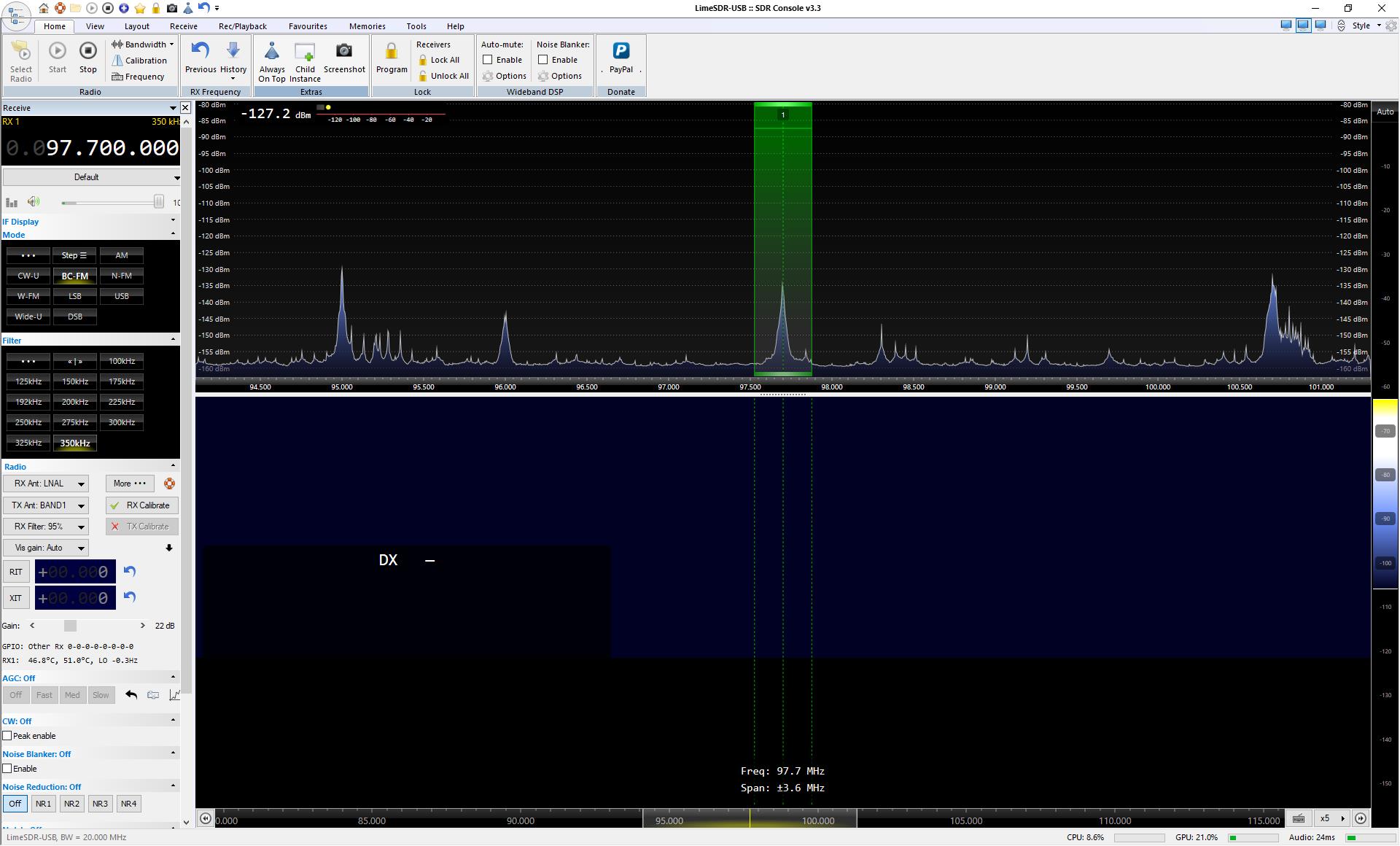

Please use the "Full Editor" below while composing your next post and ATTACH the image. So we can see all the important stuff on the edges.
Only then will somebody be able to help.

I don't know if I did everything correctly but here comes the screenshot. The lag isn't visible in the image however. After my first post I noticed that I wasn't using the latest version so I immediately downloaded build 2949 and tried again. This time I wasn't able to replicate the crash at 40 Mhz bandwidth but on the other hand the stuttering/lag starts at a somewhat lower bandwidth now.

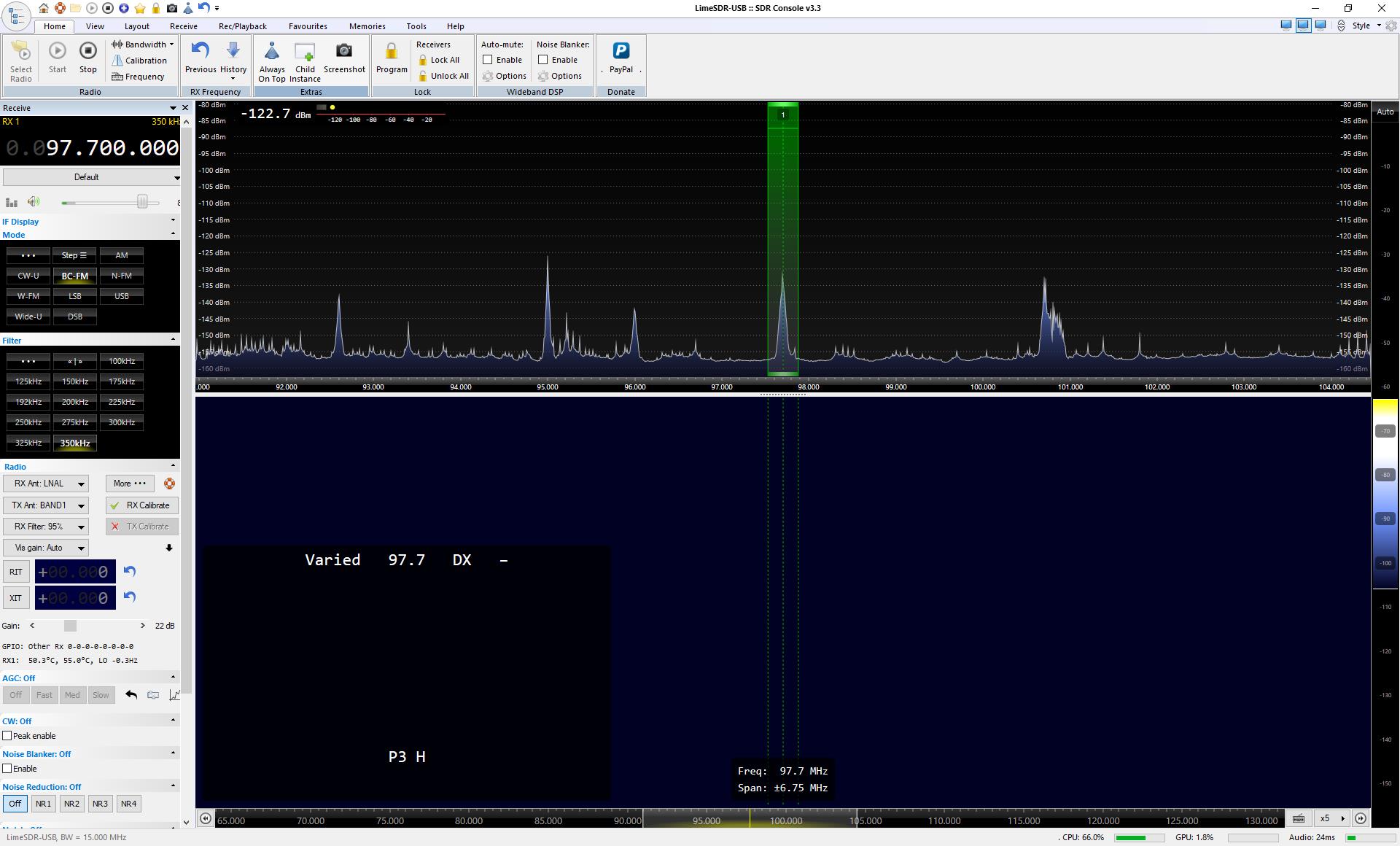

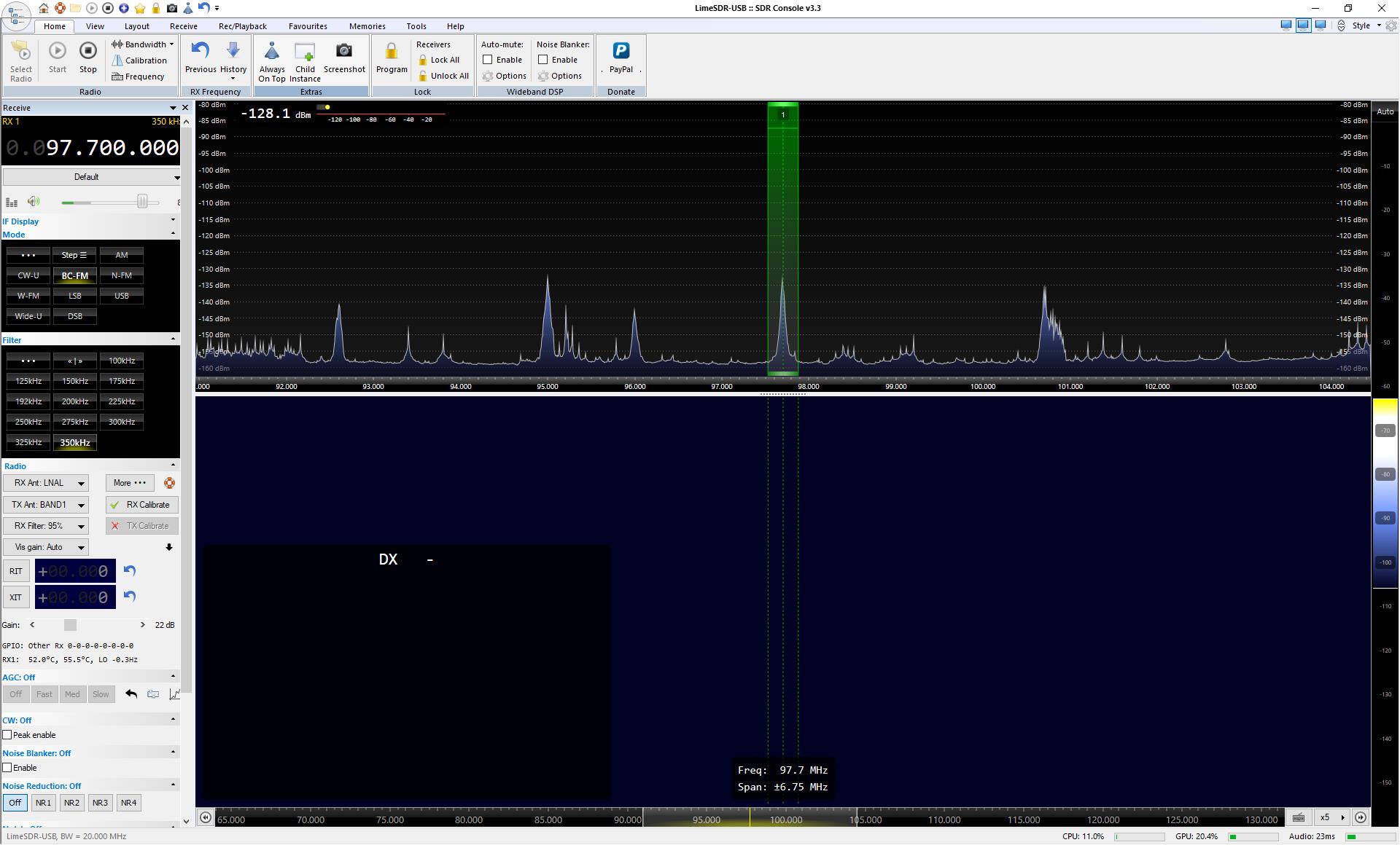

The performance gain from CUDA offloading is massive though. My one year old i5-10500T (6C/12T) with built-in graphics (another computer) struggles to achieve more than 15 MHz while this +10 year old computer with a GTX 970 doesn't break a sweat during the same circumstances. Apart from the stuttering of course.
15MHz without CUDA offloading (66% CPU load) 20MHz with CUDA (11% CPU / 20% GPU load)
