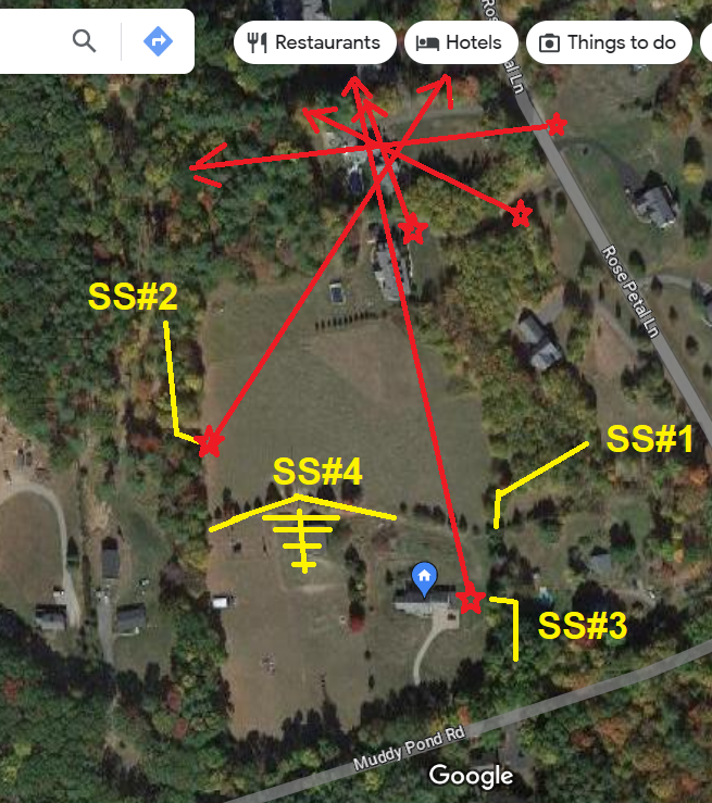

I got it narrowed down to a particular home with my active loop antenna. Luckily I know the neighbor to the south of the possible QRM'er, and texted him I was coming up the driveway to take bearings of my predicted source . The 1M loop was on a PVC pipe (mast) and anchored through the open window of my Ford F-150 inside door handle and the bottom rested inside the lower pocket in the door. So one hand on the wheel, the other on the mast looking for the sharp null with and Airspy HF Discovery and a laptop on the passenger seat.
The owner was not home (neighbor texted him) and they have a threatening German Shepard, so I didn't go up their driveway. There is a large motor home in the backyard (been there a long time), hoping he plugged in the AC cord and the charger/inverter/converter is the culprit. Those things are TERRIBLE at campgrounds when trying to work HF. Birdies EVERYWHERE! Or maybe a new EV? It was an S-9 on the 80M inverted vee of my IC-7610, broadside to the noise source!
Will take a pic of the truck with antenna, it's rather comical looking (nerdy?) tomorrow. :geek:
Here's my plots of nulls, the antennas of KA1GJU Super Station's.
Yellow lines are Super Station antenna fields w/the associated Super Station #.
The red lines are vectors of where the nulls were, the star was where the observation took place.
It shut down at some point this afternoon and hasn't returned. As far as I know, there are no solar panels anywhere (other than my own for repeater battery backup and diesel generator back up). Looks like some sort of charger or converter. The drifting frequency is very slow.
Will hopefully get on the property Friday or this weekend.
