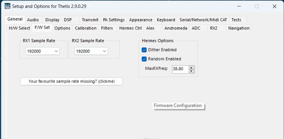

Thanks for your comments Max, I've attached a screenshot from the Thetis menu for reference here:
