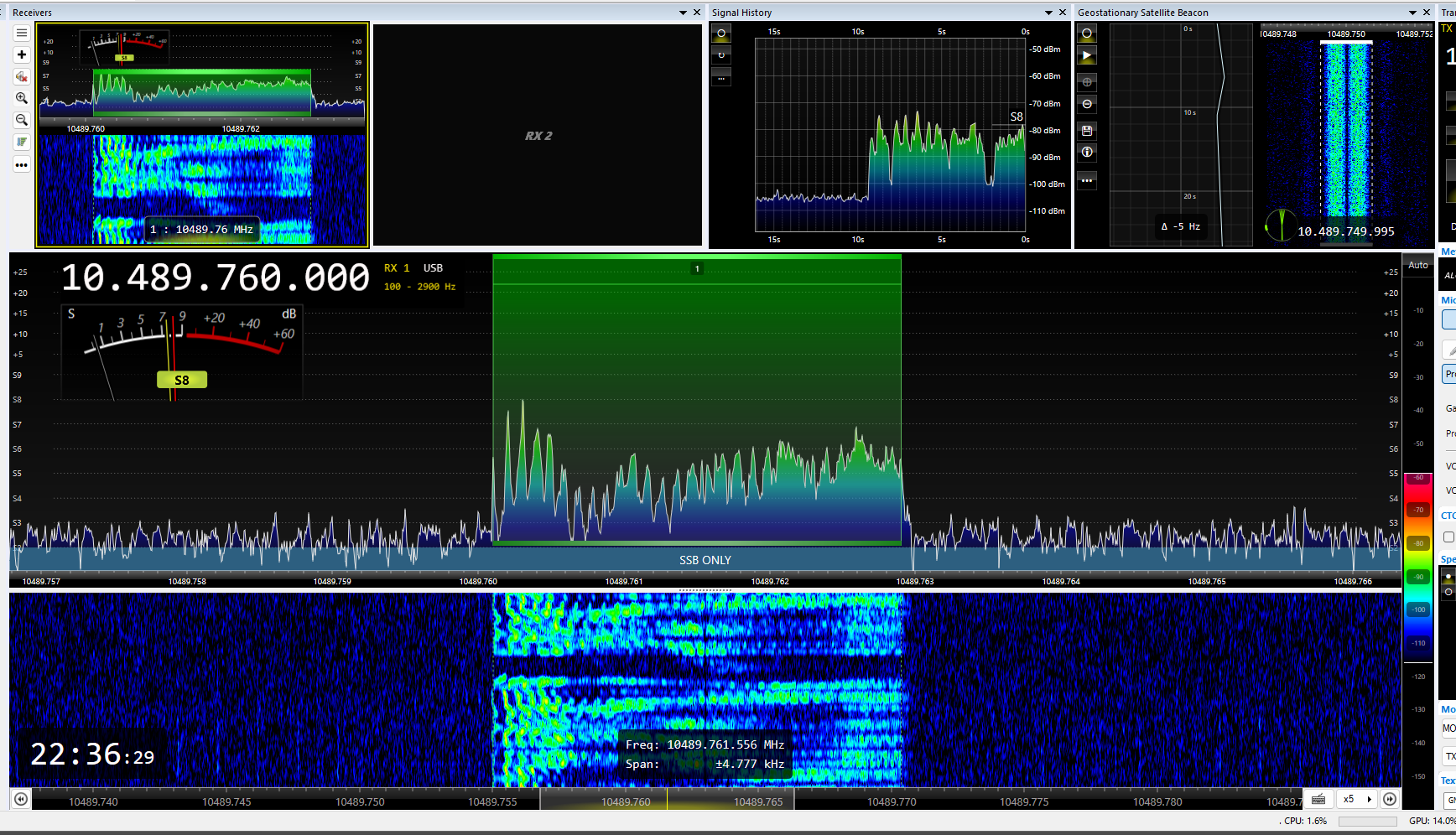

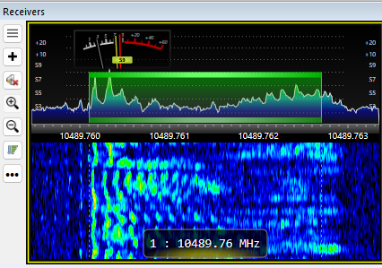

I detected a bug, when changing TX filter setting e.g. from 2k7 to 2k9 for some testing...
If I want to change it back from 2k9 to 2k7, the TX settings still using the increased bandwidth settings.
This problem happens for all version of V3.3 and also earlier V3.2 versions.
Used radio is a Pluto Version B.
Changing to other profile (untouched), the standard setting works as expected, until change is done...
I can bring it back to normal work, with a complete uninstall / reinstall of SDR console.
Update/upgrade do not solve the issue.
I´m not sure, where the settings are stored (e.g. registry or user data)...
See attachments for details of TX bandwith...

You trimmed off critical information. The radio settings dialogs must be shown. Your nice pictures are likely useless as posted. Do not edit the pictures unless you used the "prt-scrn" button. It is OK to trim off or blank the windows underneath the SDRC window(s).
