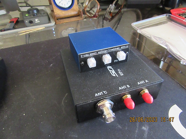

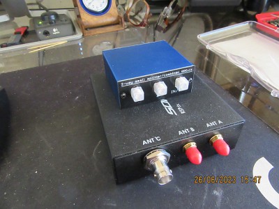

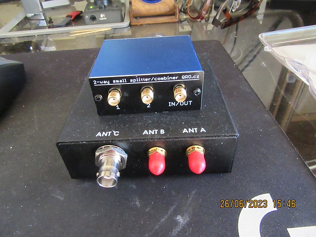

I came across this splitter the other day (i'm not associated with them) , i need one for the FT-2000 and the Rspdx using the rear in/out and rx button on the 2000 .
One is turning up in a few days , it looks nicely made with input protections , there is also one that is amplified but i got the standard version .
I'll keep you updated , cheers .

Turned up today , rspdx for reference , now for some connection leads , 1x sma to bnc 1x sma to PL259 (both for rear of Radio , 1x sma to bnc to rspdx all using rg316 cable , cheers all .

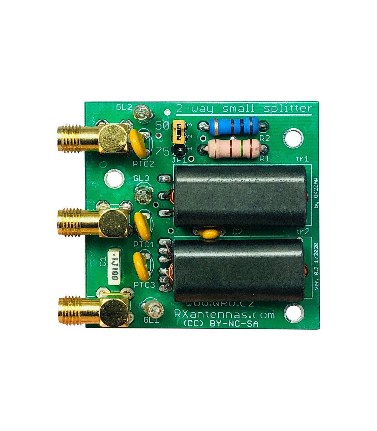

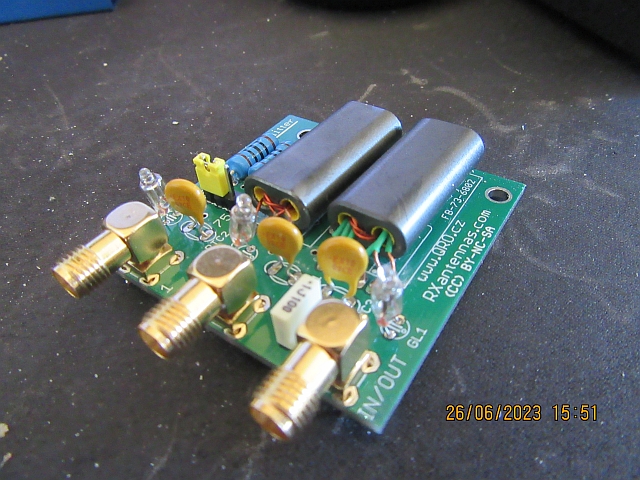

Um um um er ah that is worthwhile for the protection if you use it ONLY for reception. If you use it for TX the RX on the other port WILL (most likely) go down. That board would not like 100 Watts from a transmitter, itself, based on components I can see. And it has little or no isolation receiver to receiver in a real world setting. (Receivers may be designed to work with nominal 50 ohm sources; but, their actual input impedance may be VERY different.) Think carefully about where all that RF is going when you transmit.

What part of the RX don't you understand?jdow wrote: Tue Jun 27, 2023 12:25 pm Um um um er ah that is worthwhile for the protection if you use it ONLY for reception. If you use it for TX the RX on the other port WILL (most likely) go down. That board would not like 100 Watts from a transmitter, itself, based on components I can see. And it has little or no isolation receiver to receiver in a real world setting. (Receivers may be designed to work with nominal 50 ohm sources; but, their actual input impedance may be VERY different.) Think carefully about where all that RF is going when you transmit.
Edited next day- And
Parameters
Impedance 50 or 75 Ohm
Insertion loss: around 0.5 dB
Split 3 dB, together with IL around 3.5 dB
Isolation more than 30 dB, 160-15m more than 40 dB
SWR on splitted ports better than 1 : 1.1 on HF, resp. 1 : 1.19 on 6m
SWR on main port around 1 : 1.3 on HF, resp. 1 : 1.4 on 6m
Maximal current continue 100 mA
Maximal voltage around 65 V

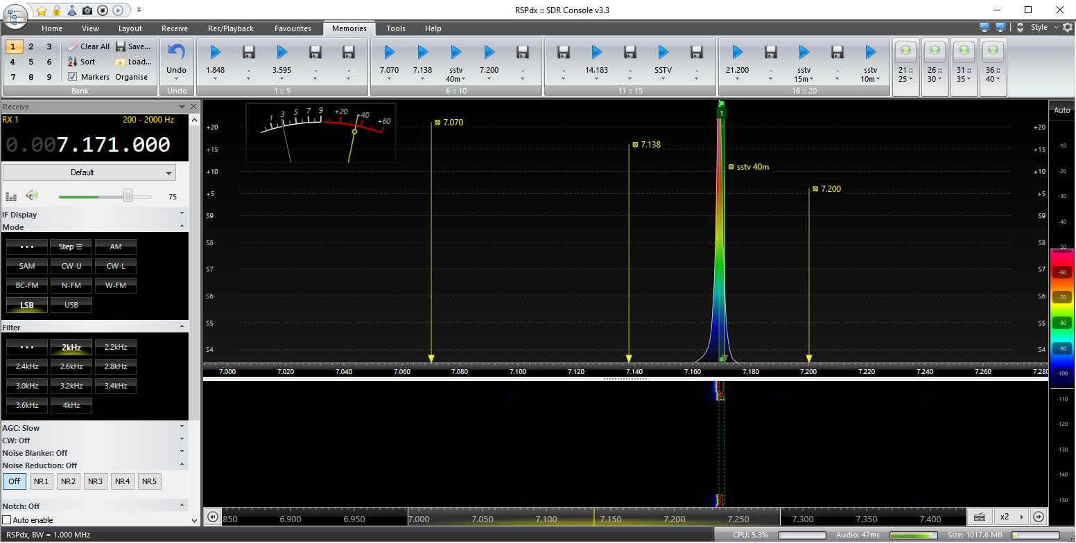

Just in case anyone is interested as a follow on re: the splitter ,
1st screenshot is sdrc parked on 7138Khz and sstv being sent out on 7171Khz using 150W
2nd screenshot is sdrc "on" the same frequency while TX sstv still using 150W

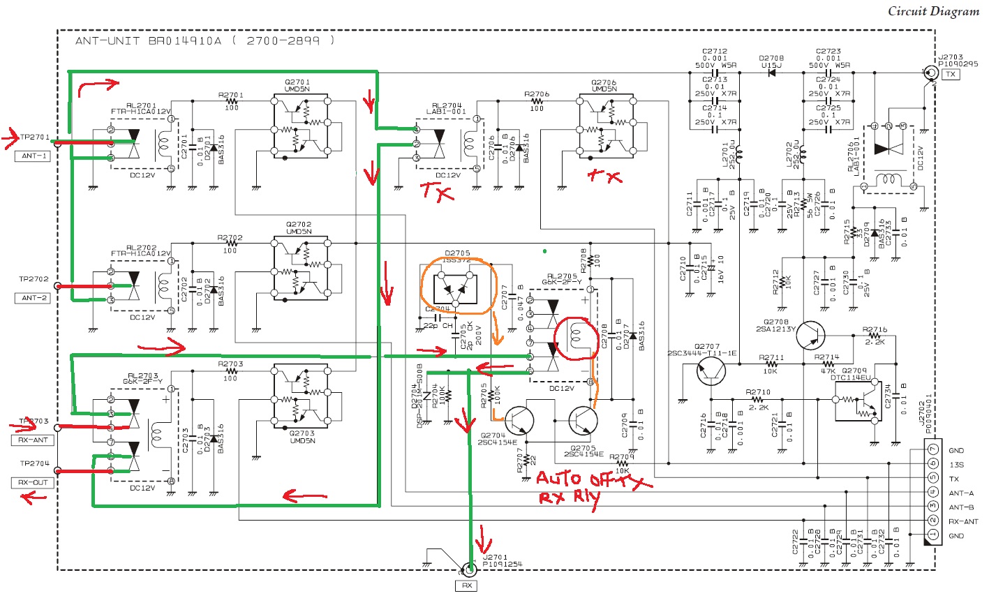

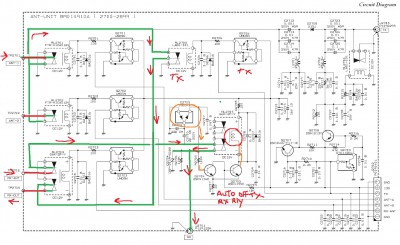

On TX the radio (Yaesu FT2000D) disables RX by disconnecting the antenna path using the internal relay in the radio and therefore to the splitter .
cheers , Paul
cheers , Paul
