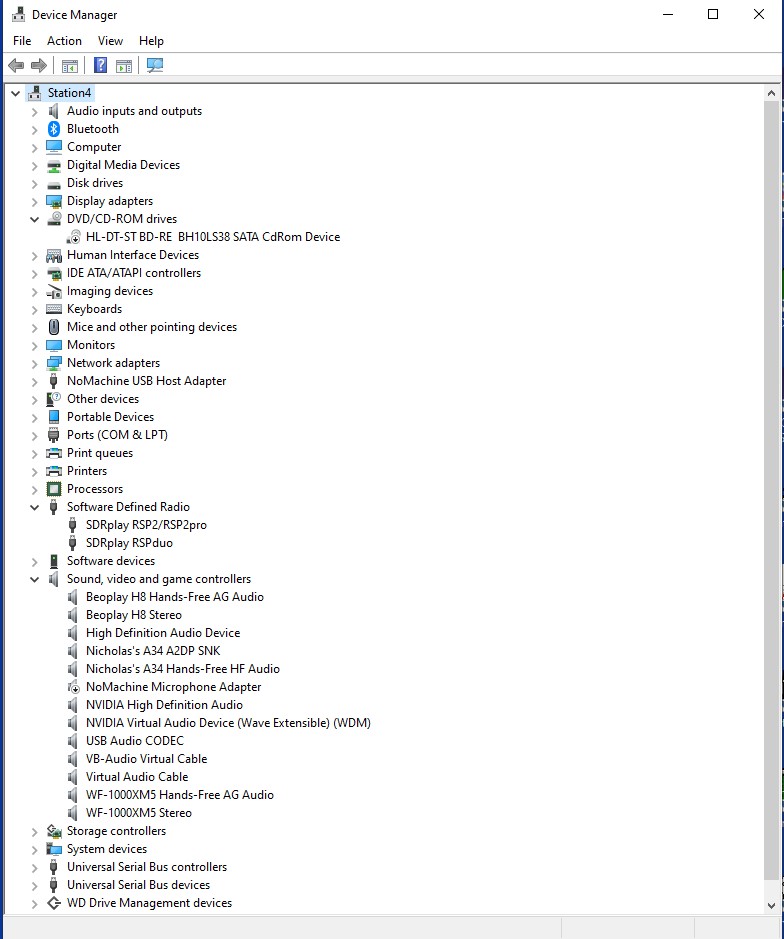

The only was I have found to persuade SDRC to detect one RSP radio is to physically disconnect their USB connections and delete both drivers using Windows Device Mangler (see attachment 1)
Then perform a soft reboot [the operator spinning around three times anti-clockwise and clicking their fingers is assumed].
Attachment 1 - Windows Device Manager Assigments
Station4-Device-Assignments-2023-10-25 074619.jpg (115.29 KiB) Viewed 2301 times
On re-connecting a single RSP radio normal operation for that receiver seems to be restored.

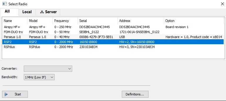

If I then physically reconnect a second RSP receiver and try to select it (noting that Windows has found the device), The SDRC scren changes size as if it is straining to do something and the message in the title bar says "(Not Responding)". After what I assume is a timeout period it reverts to passive mode and I can only select Perseus.
SDRc Device Assigments
SDRc-Device-Assignments-Receivers-2023-10-25 074850.jpg (51.62 KiB) Viewed 2301 times
Any further selection of RSP receiver is not possible and then only way seems to be to delete them and restart the system.

Nick, not totally clear by what you mean by "delete". I think you meant delete from Windows? After you have run the SDR Play API and detected each receiver in turn using the RSP software (which I think is what you meant by "deleted"?) and so now you see them in the Windows Device Manager (as shown in your screenshot) did you also delete both of the Definitions in the SDRC "Select Radio" dialogues, the try re-searching for them again inside SDRC?

Delete in this context means deleting (but NOT) unistalling the devices drivers from Windows Device Mangler, absolutely no need to uninstall the drives as they are known to work.
On the next run of SDRC, Windows then reloads them and most times is succeful in making the appropriate decision to allow SDRC to connect.
