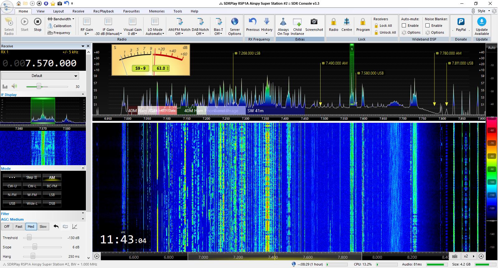

If I activate automatic IF Gain, I will get pumping as well, but mine is random (lightning strikes, electric fence pops, or ???), nothing that ratchets up and down like yours.
I noticed my radio controls are slightly different, but mine are all operated via the server feature.
Top image is IF Gain OFF @ -30dB
Lower image is IF Gain Automatic @ -30dB , Note the random pattern of noise floor jumping vs your video that rises and falls in ~2 second intervals.
IF Gain Manual @ -30dB
IF Gain Automatic @-30dB
