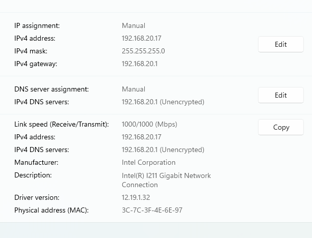

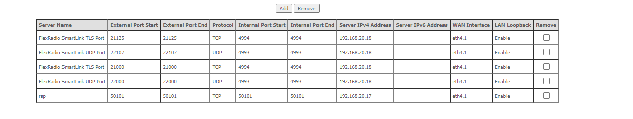

HI .. Very new here although i have searched through forum for an answer .. but to no avail .. but i did try .
Using Server Sdr
RSPA1 V3
WIN 11
I have Static Ip my computer
My Internet ip is Static
set up port forwarding with port 50101 but when trying to connect i get the ON-Air OK .. when i enable LAn loopback in NAT i have password issue.. but when i dont i get not listening .
Thanks for any help

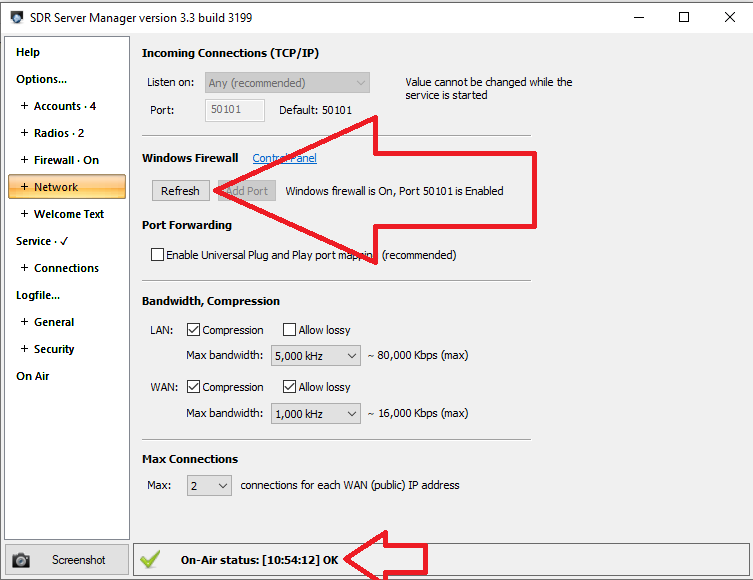

In the Network Tab of the Server manager, did you click on Refresh Windows Firewall for port 50101?
Do you see a green checkmark on the bottom saying On Air Status is OK?
See attachment.
Also check out this pdf, starting at page 17:
https://sdr-radio.groups.io/g/main/files/Version3ServerHelpFiles/SDRConsoleV3-ServerGuide2.pdf
Did you make a radio definition for the RSP1A as well as a account for yourself and/or a guest account? The guest account has to have the EXACT username and password in the Accounts Tab and the Default Server Account in the ON Air tab. Keep the password simple, since the guest account info is exchanged automatically, it really doesn't have to be complicated. I'm still using the username/passwords from SDRC v1.5 ! ! !
See attachment.

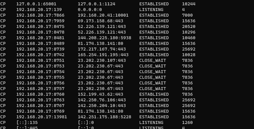

Wireshark showed that SDR console sends packets to srtb.msn.com Whats the reason?
Re: Sdr Server
FWIW, srtb.msn.com seems to be a front door for Microsoft's Azure services.
