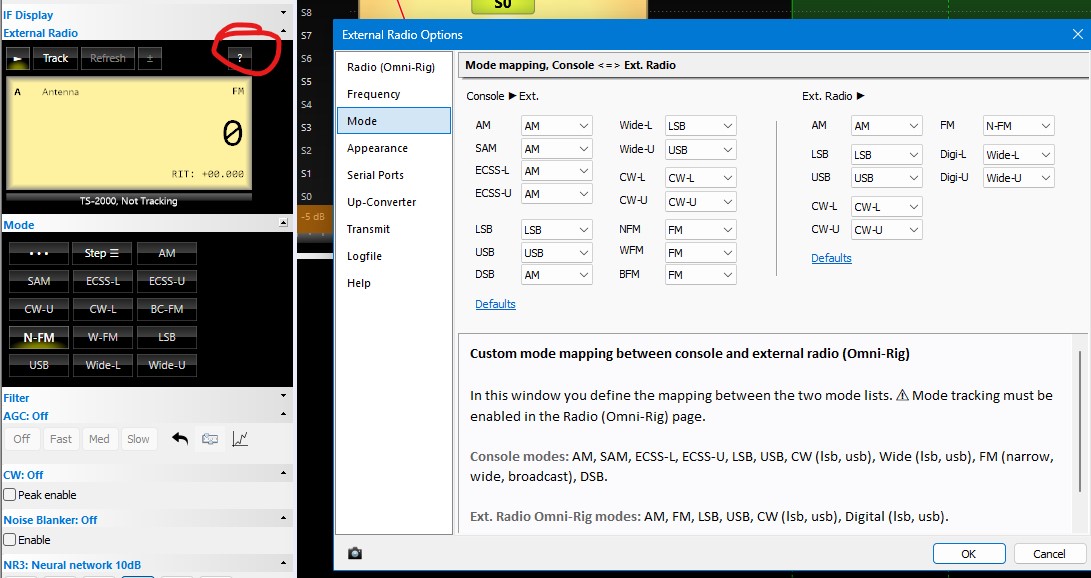

Have you seen the Mode Mapping in the external radio Options/Settings? Press question mark top right of the External Radio window (see attached picture).
How exactly are you using SDRC? How do you want to decode data? What data mode?
