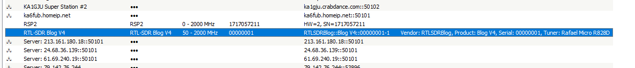

That's very odd. Please see my screenshot attached. Nothing like the same entry. I thought Ezcap was the brand of a totally different chipset? Perhaps somehow it's being mis-reported, tough not at all sure how as I would think it reads this data direct from the dongle itself. Did you buy the dongle direct from RTL-SDR Blog themselves?
Just to be sure, can you select Definitions again, highlight that entry in the list, and then press "Delete" to remove the radio. Then, once confirmed it's gone, re-open Definitions again, press Search and Add "RTL Dongle USB", then "Save". At this stage it should appear in the list as RTL-SDR V4. If it does not then I'm not at all sure what else to suggest.

Sorry Geoff. At a loss to understand this. Maybe contact RTL-SDR Blog folks and ask if they can throw any light on what you see reported (Ezcap)?
Or maybe someone else on here has some explanation? Just one last shot at it. Can you post a full screenshot with the dongle started/running and the "Home" tab selected in the ribbon bar. Please use the screenshot generated by SDRC and do not crop or edit it.
