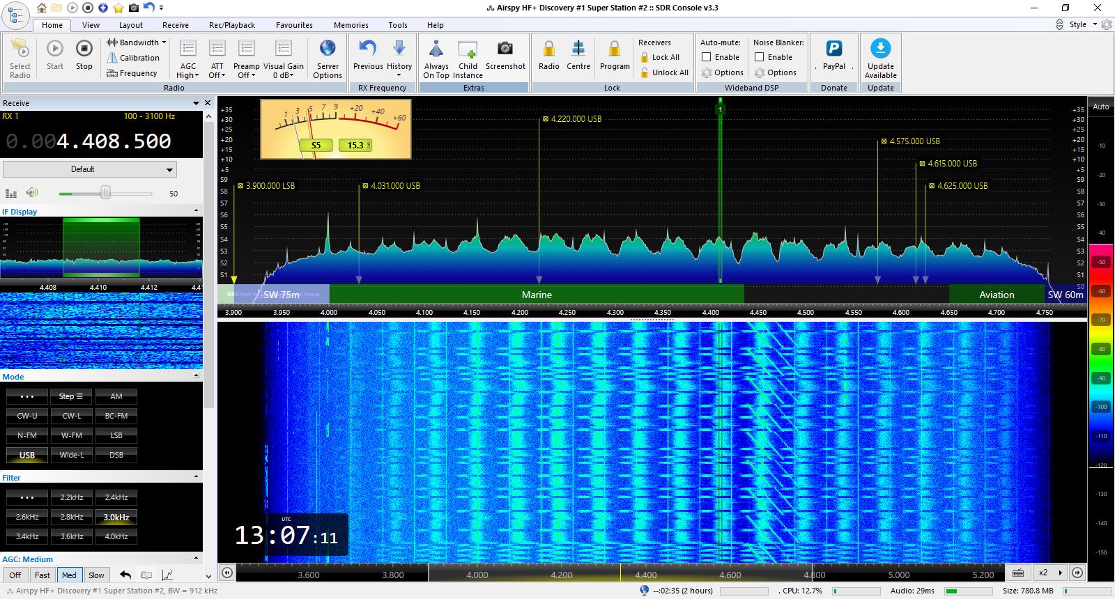

This QRM appeared within the last few days on all my servers at the QTH, worst is on Super Station #2, which was my best system. :evil:
Starts at 1800kHz to about 2900kHz and again at 4050kHz to 4750kHz.
Heading out with the Youloop and AirspyHF+ to track it down or at least get a bearing on it now.

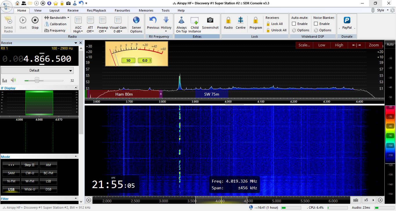

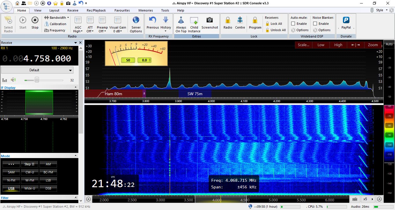

Just texted me with other devices that were off line with the breaker off. Turns out it was his house server (computer) that was causing it.
Water treatment center, gigabit switch and server were on that breaker (go figure). When he turned it back on I got the following attched image...
Says he's gonna install a new power supply in the server!
These images are of a power supply that's 2/10 mile away!! WTH?
Going off to really off (unplugged)
Turning ON
Turning ON
