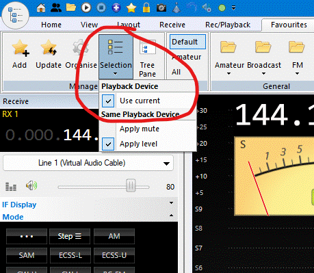

HOWEVER, I wonder if there's a chance you may have fallen foul of a setting in the Favourites ribbon bar menu. I CAN get something like the behaviour you describe if I have the "Use Current" audio selection ticked. In this case, when you recall the updated Favourite, it will simply carry on using the currently selected audio device. If you untick this option, then recalling a Favourite will always recall the audio selection you saved for the individual receivers when you updated the Favourite.

Anyway, I have fallen foul of that setting in the Favourites ribbon bar menu.
Actually never was aware of it.
So I tested my "reproducible" case with this setting UN-ticked and it now works fine.
This also solves the 'problem' where adding a new Receiver would use the same audio device as the one that was active when I added the new one.
Adding a new receiver now selects the next available VAC. Perfect.
But I wonder if this option should work on the loading of a favourite as I can't see why someone loading a favourite with several receivers would want them all to use the same audio device. I surely don't ;-)
