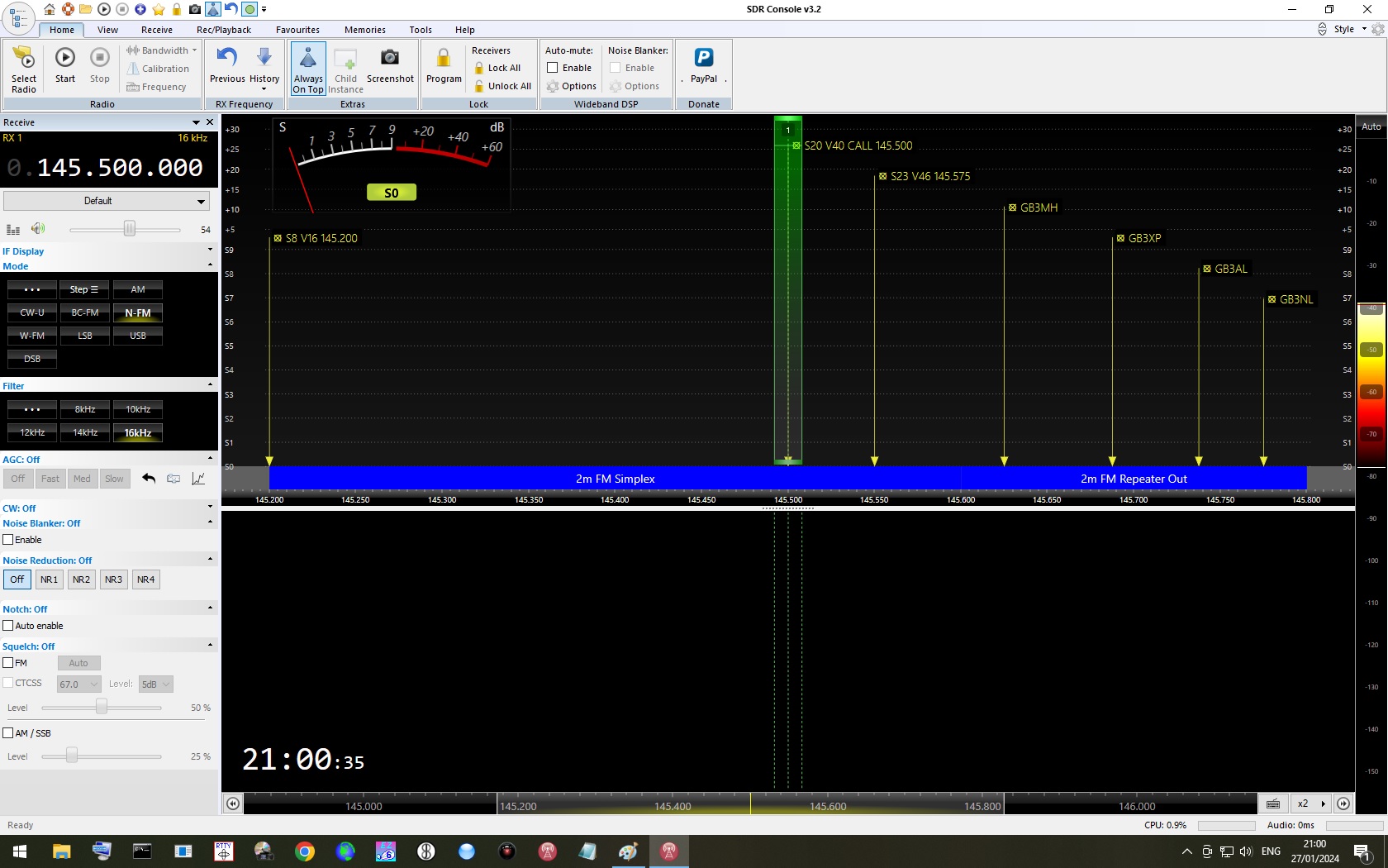

I have had SDR Console (V3.2 build 2731) running happily with RSPdx for several months. A couple of weeks ago I unplugged the PC to move it. Now reconnected I find I have a problem. SDR Console runs happily and appears to be responding connecting with the RSPdx - but no signal. I only use one antenna (in ANT A) but wondered if it had become mis-set. Surprise, surprise - I no longer have the antenna symbol under Main so I can't check or change. Screenshot attached. Any ideas?

Have you allowed SDR Console to Search for your RSPdx to update the RSPdx radio definition?

Your attachment shows the receiver stopped, the antenna selection only shows when the receiver is running.

Thank you both. I spotted that the USB connection to the RSP had lost its driver, probably after I replugged the USBs. With a bit of fiddling I re-established it and all was well. The lesson is that i need to keep note of which device is on which USB and replug them in the same place. I will probably never need to do so anyway. On the bright side it has made me register with this forum which must be a good thing.
