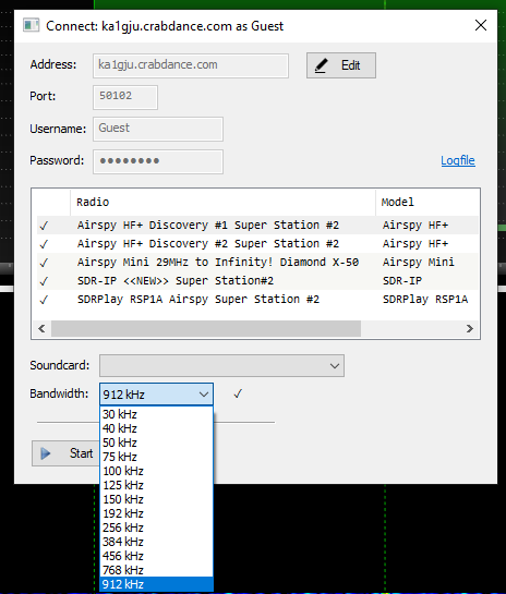

If you create a server, you can get all the way down to 30kHz.
Since mine are anywhere from 1 foot to 9 miles away, I operate all of them via the server feature. I can even operate the two SDR's connected to this computer (KA1GJU Super Station #1) as a server. Here are my bandwidth choices, see attachment. You can make the server public or private, you just have to create a guest account and place a guest account name and password in the "On Air" tab of the server manager. Buried in the files section of the groups io site is a pdf I created on how to set up a server.
See pg 17 and beyond of this pdf:
https://sdr-radio.groups.io/g/main/files/Version3ServerHelpFiles/SDRConsoleV3-ServerGuide2.pdf
- LowBW_Server.png (21.36 KiB) Viewed 14829 times

Kriss, thanks for your reply. Most interesting!

Kriss, my current location is (sadly) one of the worst you can imagine - so would be of no use to the community.
But I took up your brilliant suggestion and it works perfectly, as you said.
