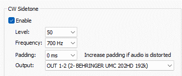

My sidetone settings in SDRC. I use padding zero to reduce latency to the minimum and I get no unwanted clicks:
CW Settings.gif (10.78 KiB) Viewed 20295 times

Many thanks but my question is much simpler. I have already concluded local sidetone to be essential from my pov. A lot of time can be wasted trying to combat latency effects upon local monitoring. My question is more about actual keying of the HL2. Does the remote PC key via MIDI, a COM Port DTR line or what?
Incidentally, for your local set up I note your use of a UMC 202HD. I presume this is using a dedicated ASIO driver? Latency minimisation?

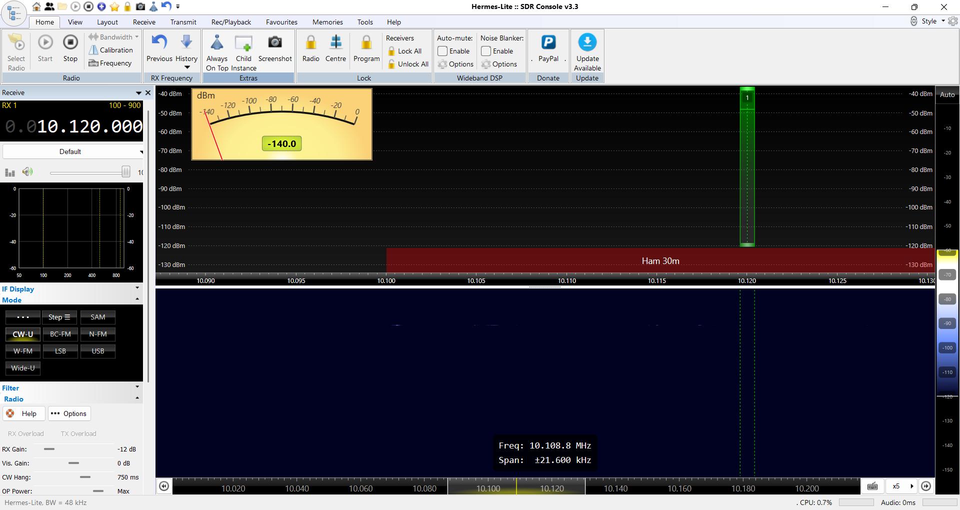

I'd like to report the same problem on my side. New HL2, works fine with Tethis. It is correctly recognized by SDRC, but when I start radio, after less than one second on RX it switches to TX. Output is real, measured on my external W-meter. It happens both in CW and SSB modes. If I quickly to to settings of radio and disable its PA, RF stops, but radio is still PTT-ed. If I leave PA off and restart radio, it is PTT-ed and there is no RX (but this short period of time right after start).
I had the most recent v3.4 beta version, but it happens also on v3.3.
Here is the screenshot:
Any ideas?
