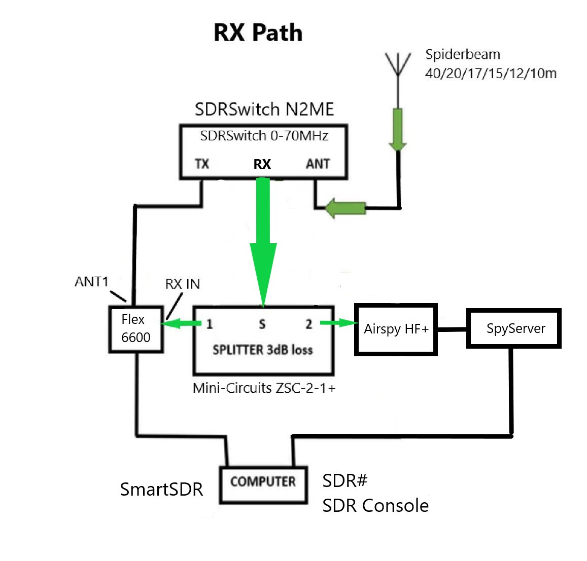

I am comparing RX path performance using WSPR according to this setup

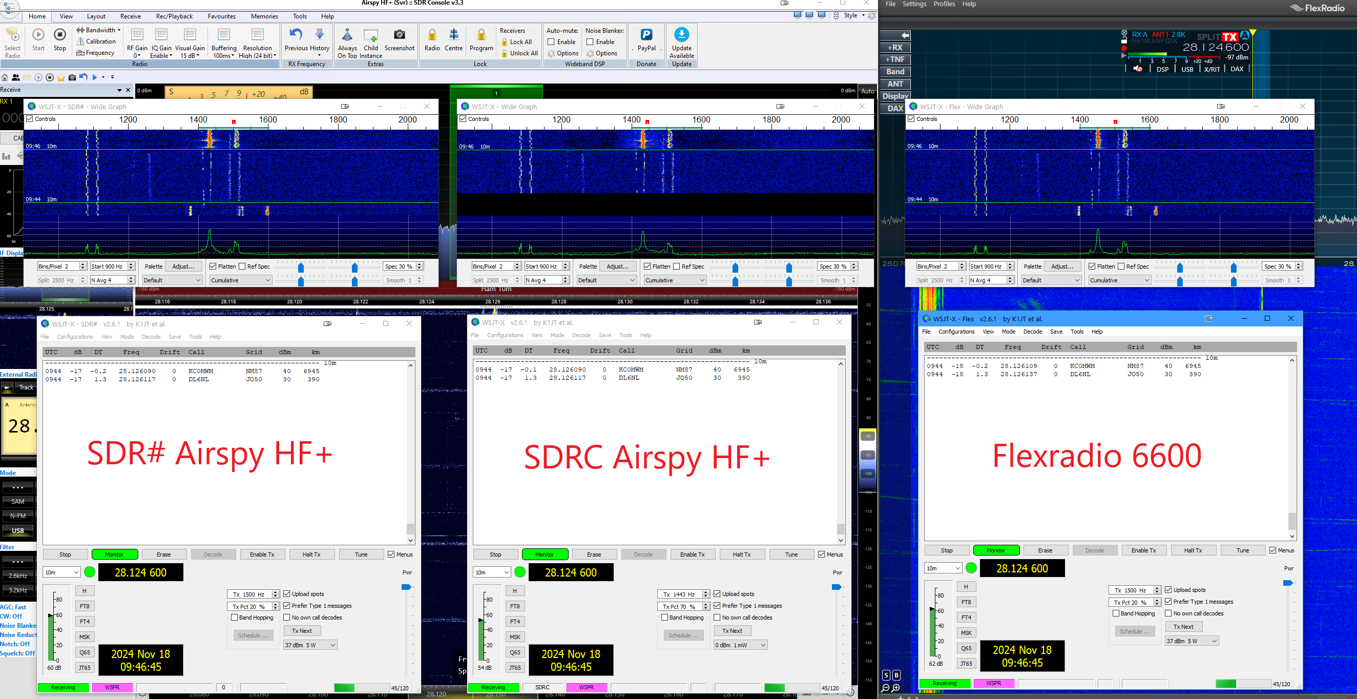

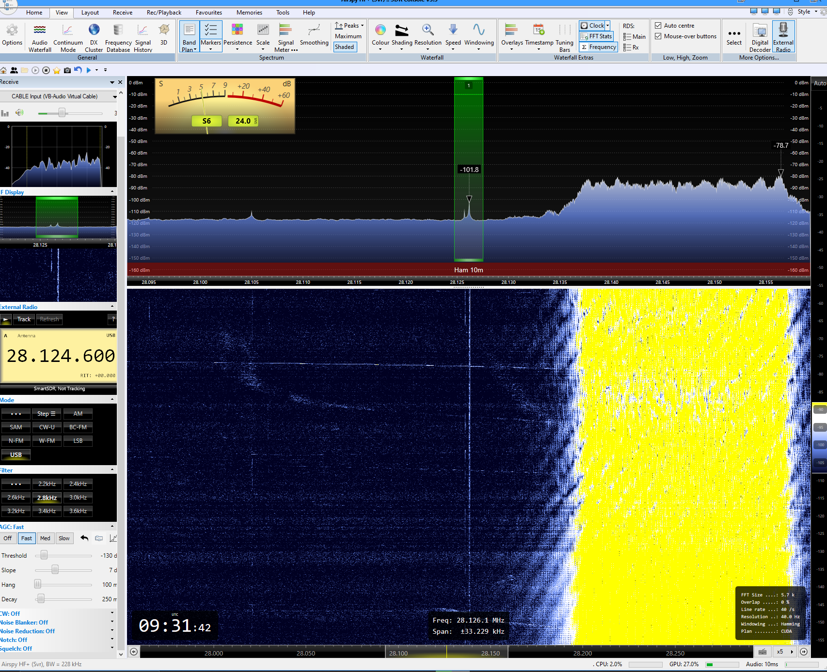

In SDRC I can see interferences (horizontal lines) it looks like splatter from a nearby station. I do not see any of these in SDR# or SmartSDR. Therefore I think it might be a misconfiguration on my side in SDRC?

I would guess that it is down to the way SDRC calculates the pixels to display. Simon accentuates weak narrow band signals that appear in the FFT bins that together make up the pixel for display. It may be a "feature". It is supposed to make detecting weak signal presence easier.

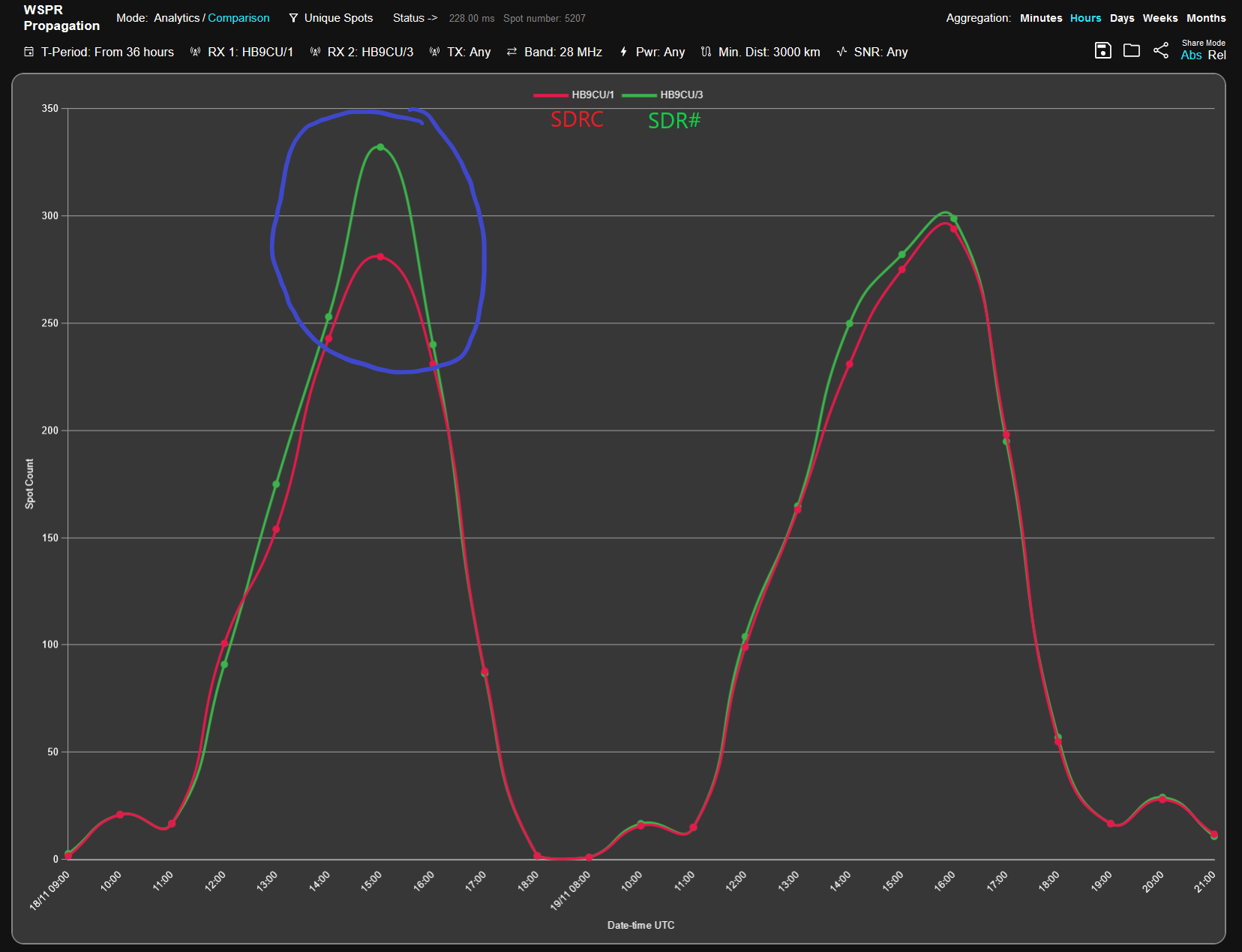

It seems to impact decode performance quite a bit

In your video, if you see the way that not only the noise floor is jumping up and down but so simultaneously are all the signal levels. Looks awfully like AGC pumping due to strong signal somewhere within the front-end bandwidth of the HF+.

I repeated the comparison today and could no longer reproduce the problem. As expected, today's numbers are very close to each other. I will wait for the next opening of the 10m band tomorrow and see if the issue occurs again. The AGC settings are the same and the DSP functions are all turned off. Both SDR# and SDRC are connected to the SpyServer. SDR# has no such pumping behavior.

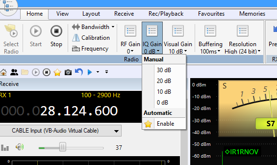

Setting IQ Gain from “Enable” to another manual value solves the problem. No pumping anymore
