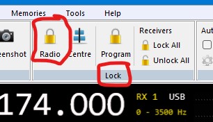

Therefore another possibly relevant feature that may interest you is the "Lock Radio". This locks the LO/centre frequency of the SDR regardless of inputs to the waterfall. i.e. it allows you to tune within the available span of the SDR without re-centreing the SDR hardware radio. I think under certain circumstances/operations it can "unlock" though (sorry, Simon has mentioned what the logic is but I forget exactly - Possibly recalling Memory/Favourite or inputting a frequency change by keypad? - you could find this out by deduction) so needs to be used by observation.

Thanks, I didn't know about those "lock" options, I'll take a look at them to see if they're useful to me.
