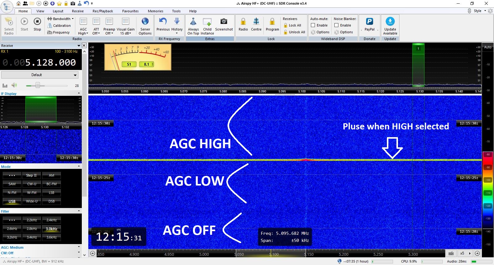

Max, I don't see a rise in the noise floor with your method on mine. There's a miniscule hint of a rise, but nothing really obvious. But there is a 'thump' or pulse, but
noise floor returns immediately back to previous levels.
Re: AirspyHF+, Disconnect antenna, DSP AGC Medium, adjust visual gain to ~0 (S-meter) noise, toggling Hardware AGC OFF/LOW/HIGH. There is a bump, but it returns to ~0.
Image is me cycling AGG OFF, LOW, HIGH:

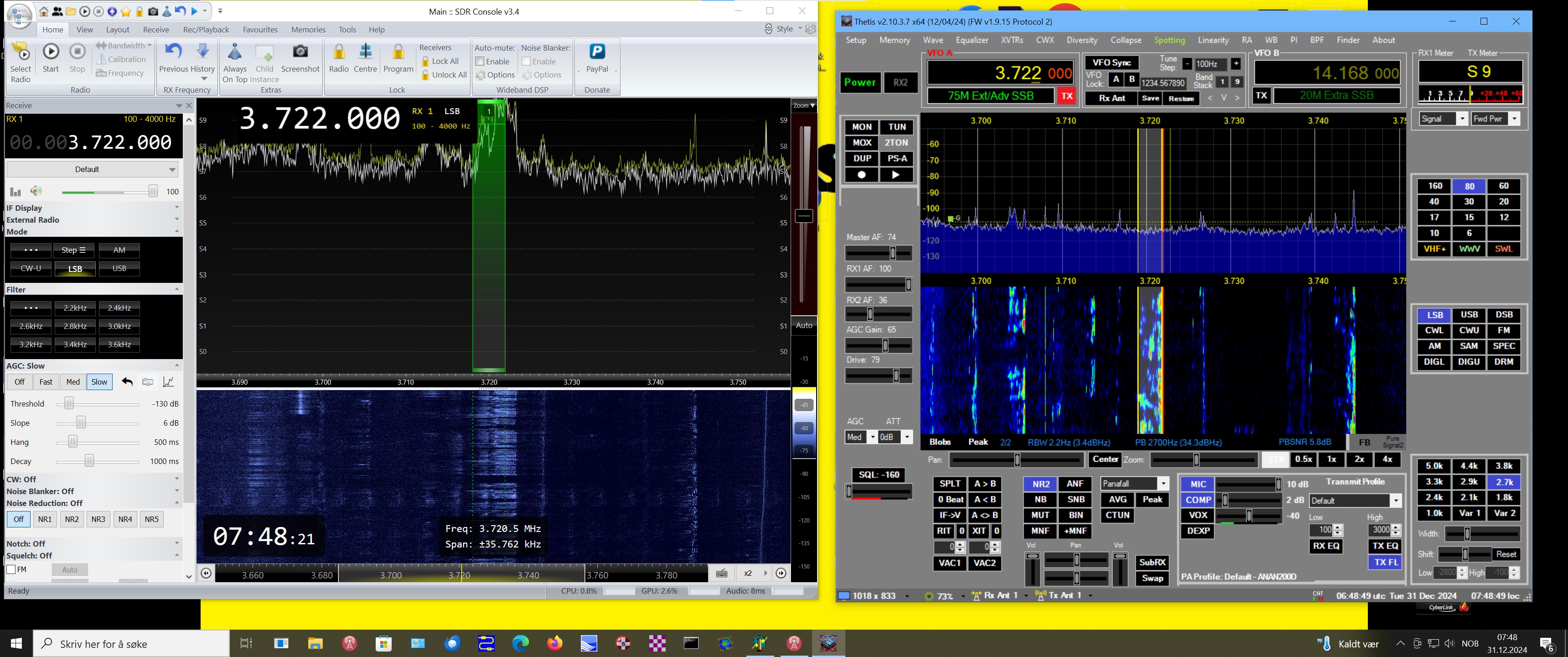

Happy New Year to all,
Thank you for your kind comments, I've been hunting on other fields during Christmas ...
Attached is a screenshot showing both Console and Thetis taken
more or less at the same moment.
I'm not sure I know what I'm doing, but I now feel, as has
been suggested by jdow, that a gain setting is way too high,
but I simply fail to find what setting that might be.
I love Console and have used it for Q-100 work (not with the ANAN)
I don't really need it for my ANAN 200D as Thetis is doing fine.
But I'm challanged when something doesn't work as expected....
I hope someone will point out what I have missed.
73 de LA6GH
Nils
Skjermbilde 2024-12-31 074940.jpg (1009.09 KiB) Viewed 30991 times
Posts: 1043
Re: ANAN 200D - P2 - distorted audio
#18
