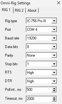

Radio is Icom 756 Pro III with Omni-Rig v1.2.
I've tried changing the Omni-Rig polling rate from 500ms to 100ms and 2000ms; doesn't fix it. 19200 is the highest baud rate available on this radio.

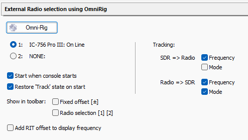

Have also turned the SDR => Radio Mode tracking ON and OFF; no fix.

A little more debugging...this "blocking" happens when ">SDR" is visible in External Radio. It seems SDRC blocks setting the External Radio freq while it is verifying the SDR freq is correct.
Maybe this step is taking longer than it should w/ RTL-SDR which adds to the problem.
