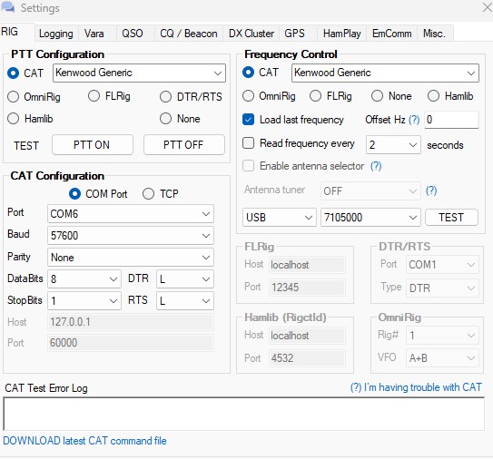

Yes, I have VaraAC working very well with SDRC and Hermes Lite 2. Worked straight off. As far as I am aware there's no need to involve Omnirig at all.
See my VarAC rig config screen attached. I'm using virtual com ports 5 and 6 created in the excellent VSP Manager from K5FR. My virtual audio cables are from VAC from Eugene Muzychenko but I don't see why you should not also use VB Audio cables. All audio should be set to 48kHz sample rate.
