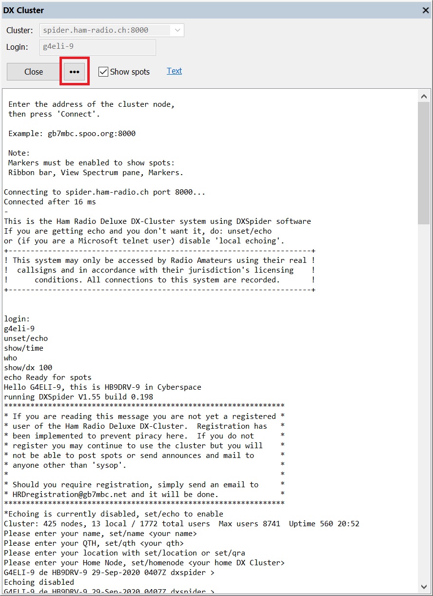

First Posting to new Forum - so apolgise if I get it wrong!
Trying to get DX Cluster to display spots and wanted to set filters at local Cluster GB7BAA ... (Don't need to see a spot by a JA3 of his local on 10m !) I can't see anyway to type commands into the Cluster from SDRConsole - have I missed it or is it still under development ? Any updates on Dx Cluster since 3.0.24 ?

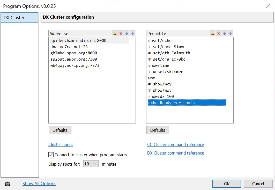

Hi Robin,
In the DX Cluster window click the ellipses button. In the Properties edit the Preamble, this is where you define any configuration. I've never applied filters myself but anything you can do is available here.
