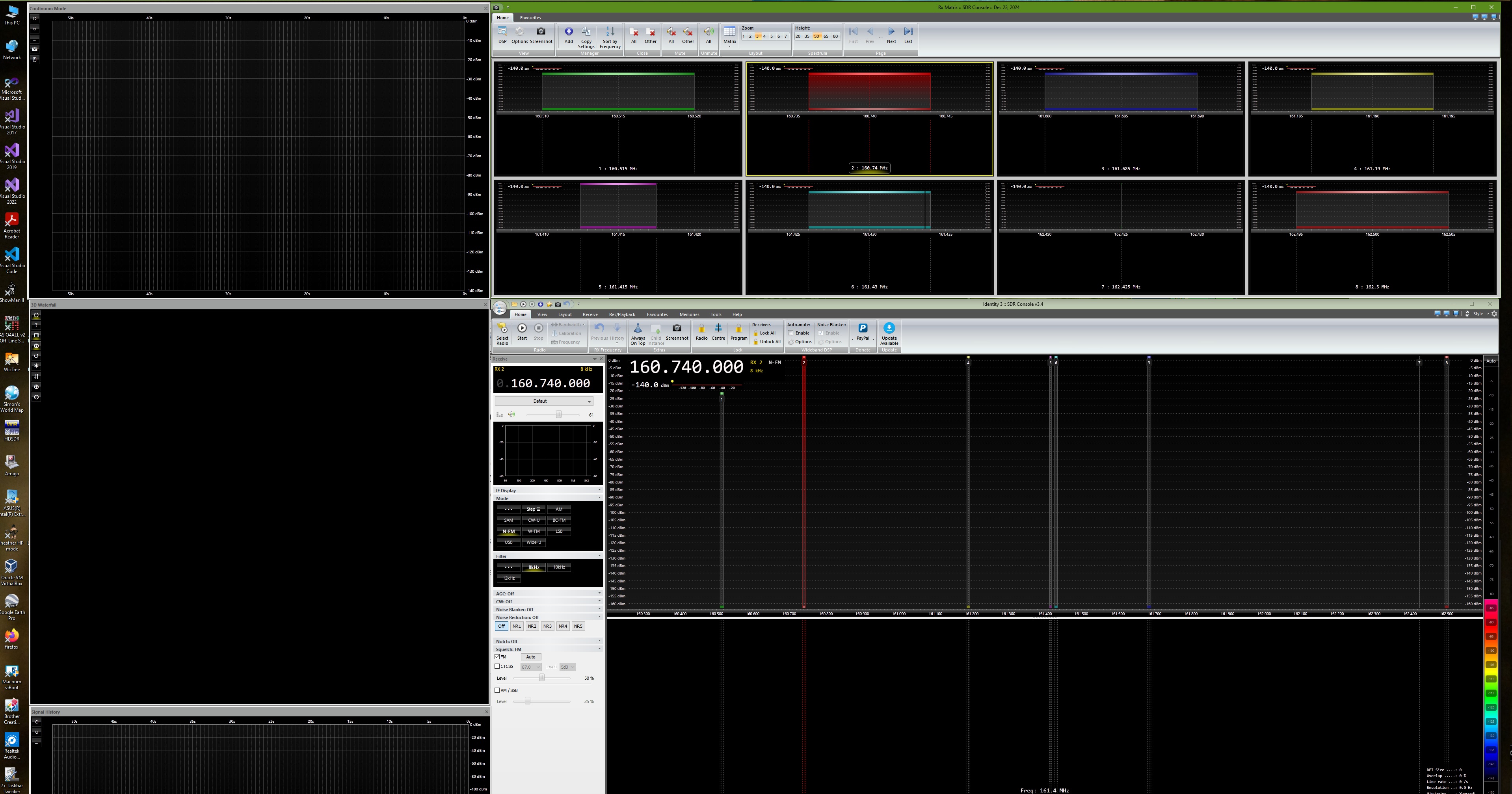

We are speaking of SDR Console here, aren't we? I got lost at "setup tab". Options menu selection, yes. Setup no. How did you get to a "Setup tab"? I've not found one in all the years I've been using SDRC.gooberpat wrote: Mon Jan 20, 2025 7:41 pm "I think, what we have here, is failure to communicate." (I have wanted to use that quote for a long time.)![]()
What I suggested was to save the entries under the setup tab only.
Some of the proposed data may not be present in SDR Console. SDRC would have to reach into the OS and find the data for a "Region" guess. And "Setup,Audio,...." is insufficient when there are several receivers running at once. Portions of the data are defined in the registry and the %AppData%. For example the "Hermes Lite" selection is in %AppData% while it's data is in the registry.
I'd suggest this is not likely to be something Simon would do. But, if you provide a very detailed description of this concept as you have started doing below Simon might like it. The description should account for SDR features such as receiving 10 simultaneous signals each with different audio outputs selected. The attached image is one of the setups I have here slightly doctored to protect the innocent. This is strictly a mail reading configuration so there is no transmitter information to post. I would imagine you'd want that.
Once you have a good design for the data structure (the hard part) the button itself is really easy to add. The code for gathering and composing the saved data is possibly a modest to annoying activity. But the start must always be with the data itself. I'd suggest storing the data in an XML file. But, that'd be a coding time decision, I suspect. Once you have this post a message to the groups.io list with your data description as an attachment to make it easier to deal with for those who are not interested.
BTW, reading back the saved data into another computer's SDRC would be impractical. Too many other configuration details would differ.
edit - Note how much of the data you want to convey might be present in a screen capture. That is why Simon wants screen captures for bug reports. If Simon gets around to this post it might be of interest to him to somehow add audio output selection to each receiver's pane.
- Identity3.jpg (1.37 MiB) Viewed 8682 times
