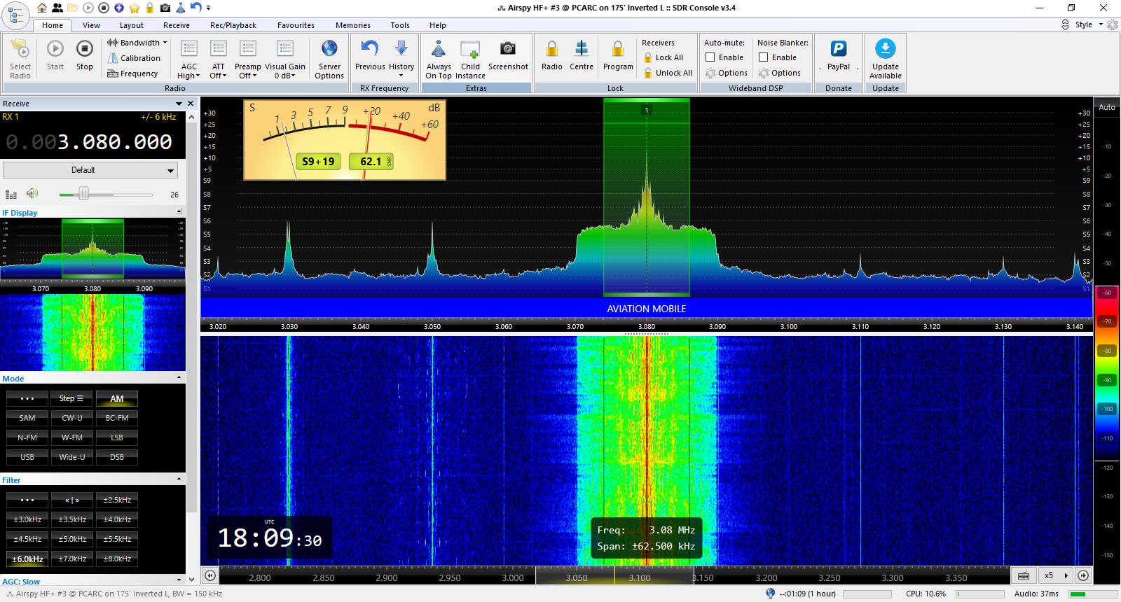

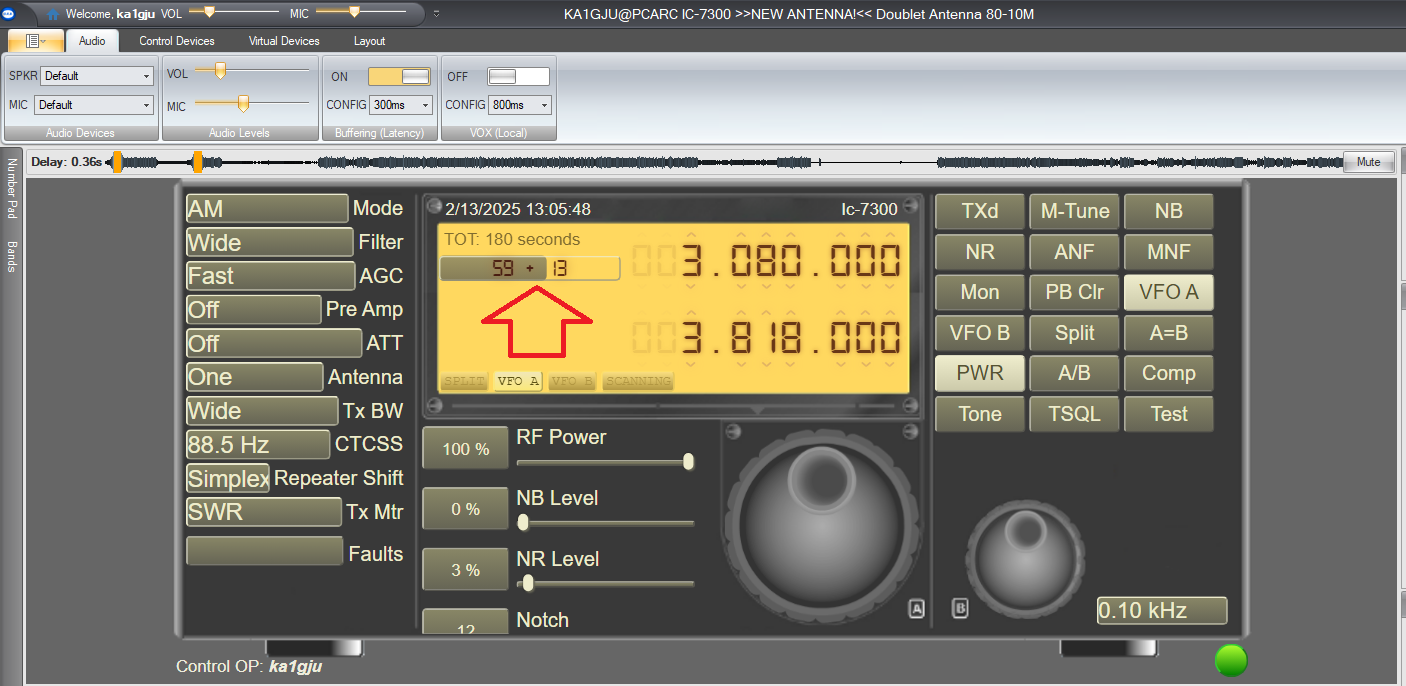

I have an IC-7300 on Remoteham's on a 80m flat top doublet at the club station, it hears the harmonic at S9+13dB of the end of the doublet (not broadside to it).
Attached are what I see/hear via two platforms. The SDR antenna is 300' away from the doublet deep in the woods and has a similar signal strength on it.
The issue with this radio station appears on all my servers that are down here in the lower part of NH. The club station (KA1GJU@PCARC) is 5.2 miles NE and my QTH servers (KA1GJU Super Station #1 thru 4) are at 5.1 miles SSW of the offending station.
I placed an adjustable attenuator in line, and it did do what it's supposed to do. When I set it to from 0 to 10dB, I witnessed a drop in all signals by 10dB, when on 20dB I saw a 20dB drop on all signals, etc. The harmonic from 1540kHz on 3080kHz was still there, just reduced by the amount of attenuation applied.
As for my AM BC filters, they are currently MIA, so I ordered some more and are due to arrive in a few days... pending the incoming snow storms.
- WPKX Harmonic as heard on Airspy with inverted L antenna
- Screenshot-2025-02-13-130930.jpeg (266.1 KiB) Viewed 14685 times
- WPKX Harmonic as heard on IC-7300 with 80M doublet antenna
- KLUV.png (236 KiB) Viewed 14685 times
