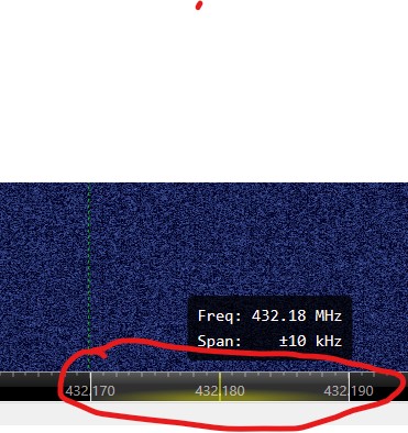

The easiest way to adjust the span on your already programmed Favourite prior to saving is to set your centre frequency first, then looking at the "span" bar right at the bottom of the display (the highlighted, light gray slider bar) left-click and DRAG the outer edges to set the span you want, then UPDATE and OK.
I hope this helps a bit? Just for sake of clarity I attach picture of the bar that you need to drag the outer edges on. In mine I first entered frequency of 432.180 MHz then dragged out the edges of the span bar to 10kHz up and 10kHz down so the span is now 432.170 to 432.90MHz.
Also have a good read of the link I sent in my last post. It does pretty much explain the steps needed to save and/or update what you want to. I have my Favourites all set up to be bandswitches this with varying spans for varying modes, so for FT8 for example, my span only covers about 10kHz display width. For the general band switch, 20m band for example, it's set to cover exactly 14.000 to 14.350MHz. For 20m CW, 14.000 to 14.100MHz.
