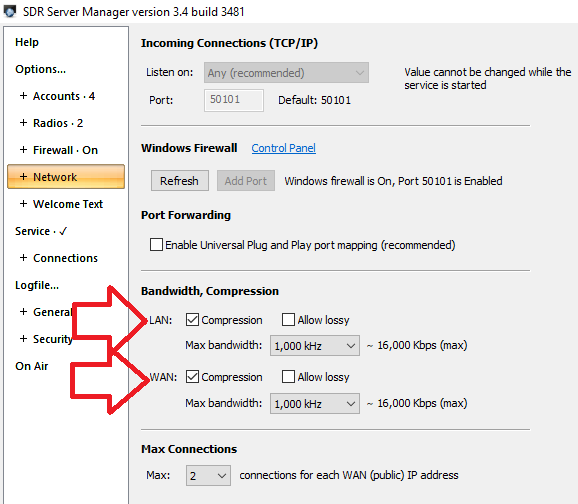

In the Network tab of the server manager, do you have the compression turned on? This will save you 50% bandwidth to be streamed on the uplink. What do you get for a speed test of the ISP?

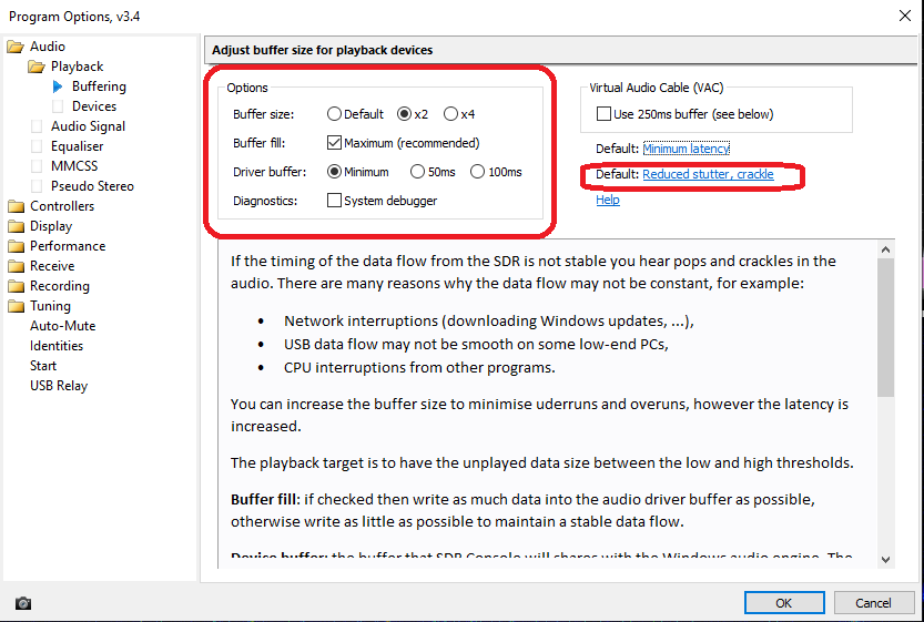

On the client end, there are some settings that may help too. Go to Settings, Options in the ribbon bar. Super Station #1 (where I am currently seated) has been set up for minimum latency. There is a default setting for reduced stuttering (small circle):
