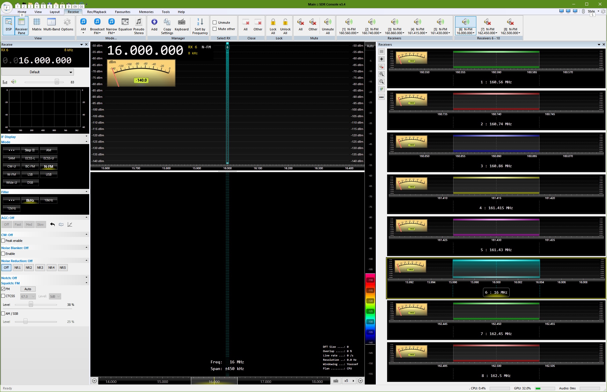

Edit: DUH! I just thought of what the problem might be. The "Receive Pane" may have gotten docked to the main window. If what he has more or less matches the attached file, then he can use the mouse to grab the "Receivers" title bar at the top of the receiver windows and pull it off the main window to its own big window.
I do keep forgetting I am entirely too comfortable diddling around in the registry. I even have an older copy of the SDR-Radio registry key for brute force recovery. That's not recommended unless you understand the registry. And I keep an "AppData" icon on my desktop. So the brute force approach is what comes to mind first. It should not be too difficult to build a shell script or a C++ utility to perform brute force export and import for registry and AppData.
- Docked Reveive Pane.jpg (610.57 KiB) Viewed 4767 times
