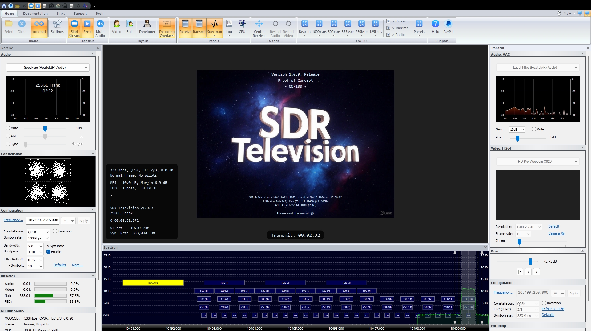

What else is running? And sizing the window to show the bottom part of the program's main window might show more useful information that has been neatly trimmed away in the image when I tried to view it. A view (or two) of taskmanager that shows memory, GPU, and CPU usage might show some hints. That will help people with experience with this tool help you.

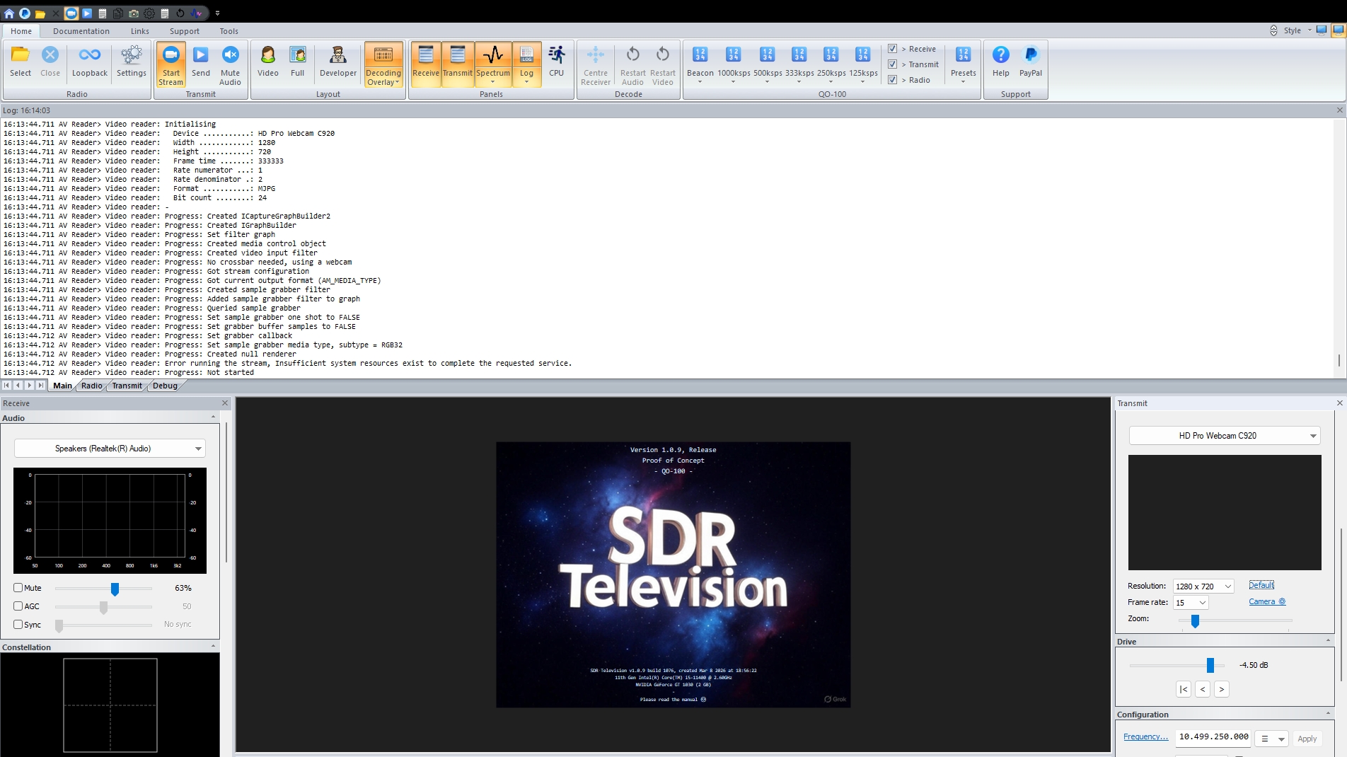

Thanks for the reply. Full screen shot attached. In the meantime, I realised that I updated OBS to 32.1.1 64bit
My current setup is now also giving problems. Is this a known problem? What should the settings be now? If I play with the camera settings in in SDR TV, the picture in OBS responds, but does not appear in SDR TV
Posts: 1043
Re: Insufficiant system resources
I don't use the software so cannot hazard much of a guess. But, what is OBS? Is it running along side SDR Television? Are they fighting over a camera video stream resource that cannot be shared?

Hi
Got it going. OBS Studio runs alongside with SDR television. The updated version needs an extra plug-in for a virtual camera. Now all ok. Thanks for the comments.

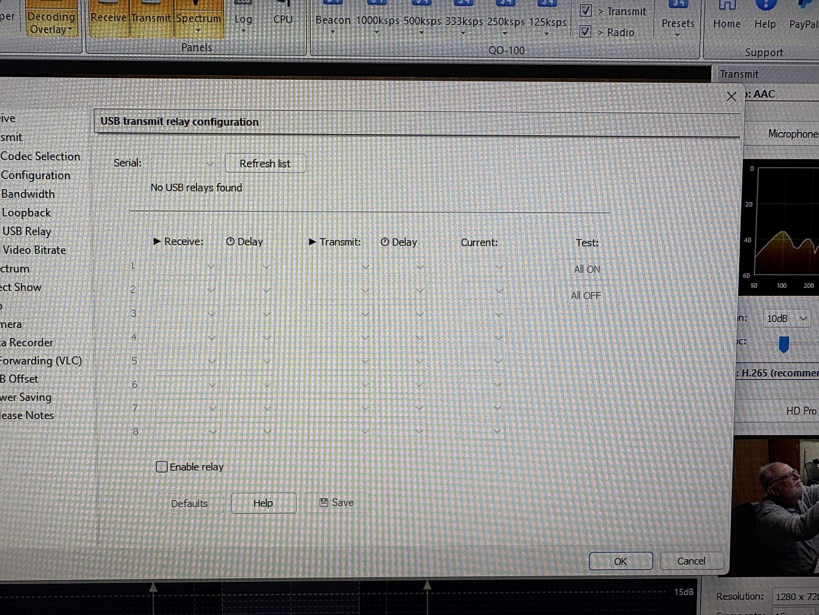

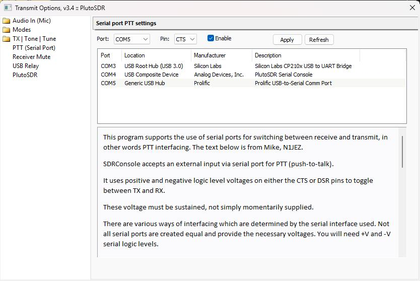

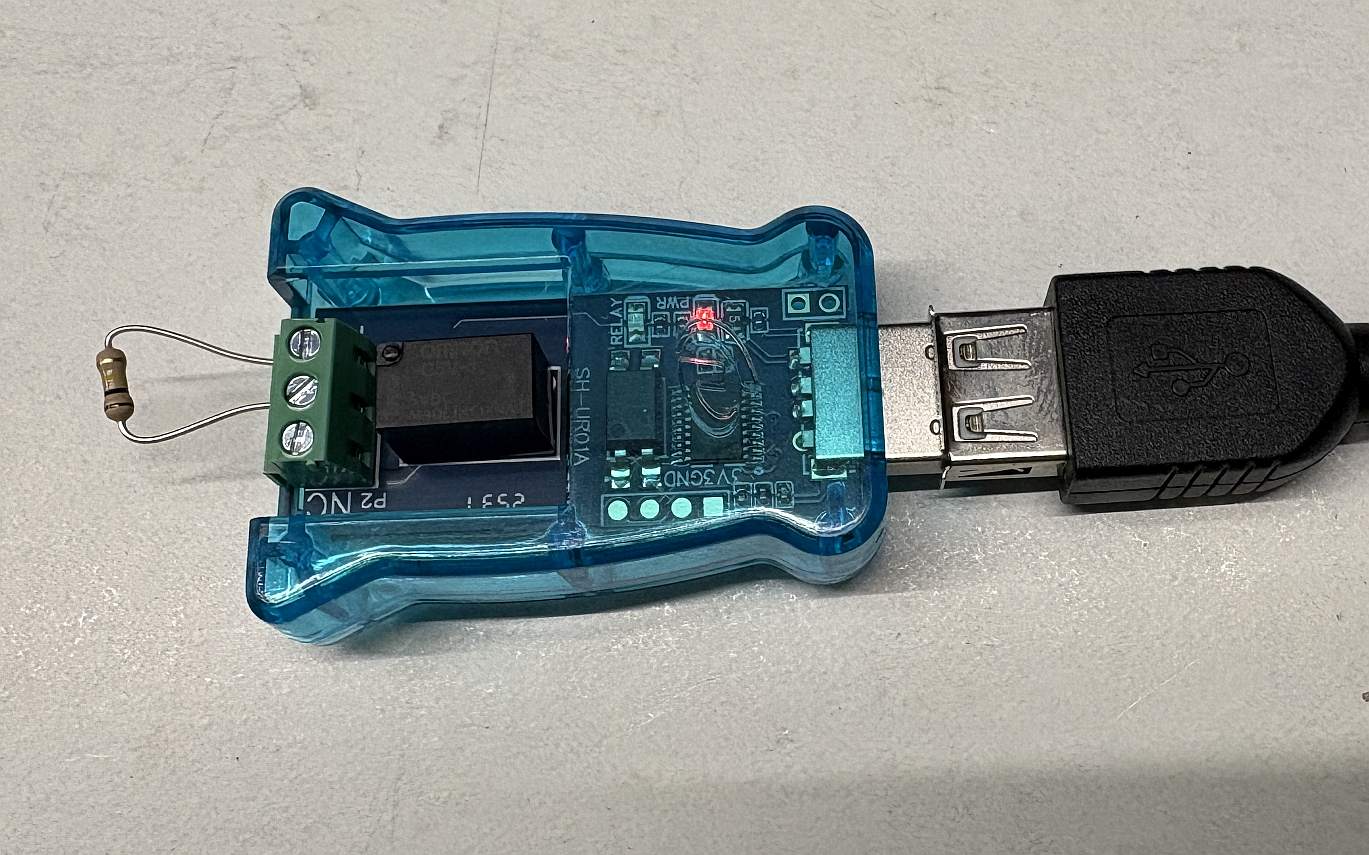

So far, all seems to work now, except for the USB relay. Driver installed.
Console sees it, TV doesn't. Same PC, same Pluto
Any ideas?
