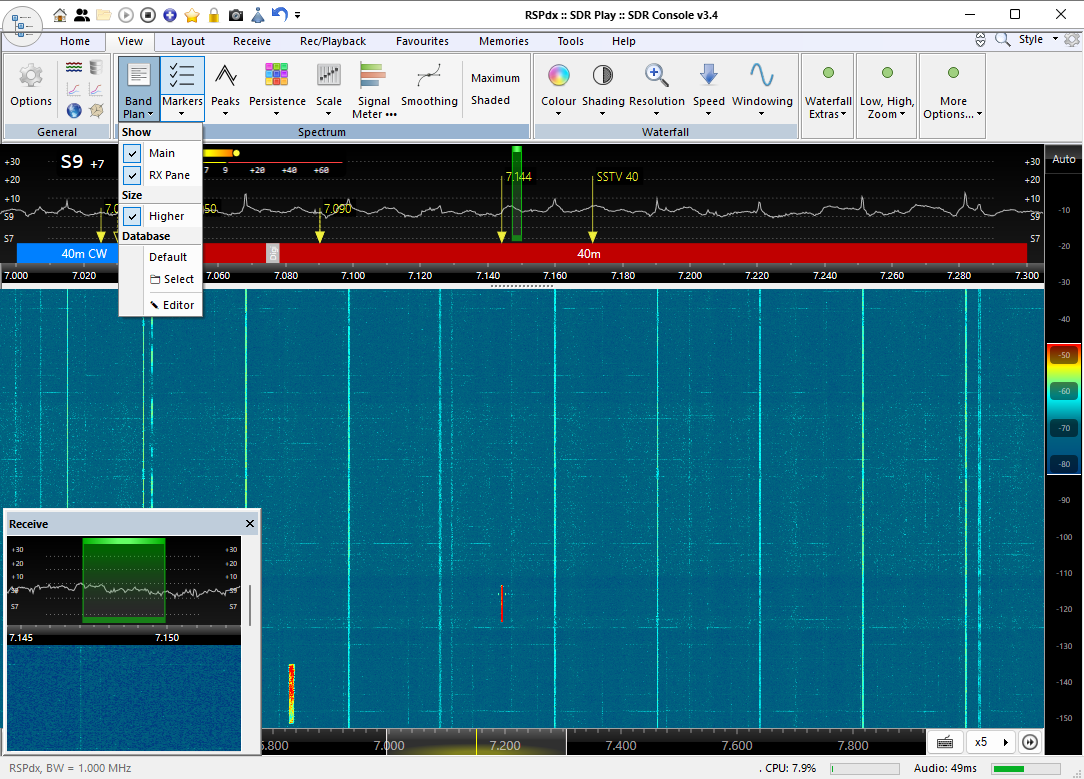

Good afternoon all.
Of late I have noticed that my bandplan disappears. It never used to, and may well have started when I updated to 3.4 b4138.
There appears to be no rhyme nor reason, one minute it's there, the next not. I have no reliable way to reproduce it, but it *may* be triggered by changing favourites and moving to a whole new spectrum view. At least I seem to notice it when I change favourites.
The View -> Bandplan -> Main entry remains checked, and I need to uncheck it, then check it again for the bandplan to return. As I don't use the RX window I'm unable to tell you if it's effected there too.
I've attached two screenshots, one with the bandplan missing, whilst still showing the checked "Main" option, then the next when I've unchecked and rechecked, showing the returned bandplan.
Any thoughts would be appreciated.
