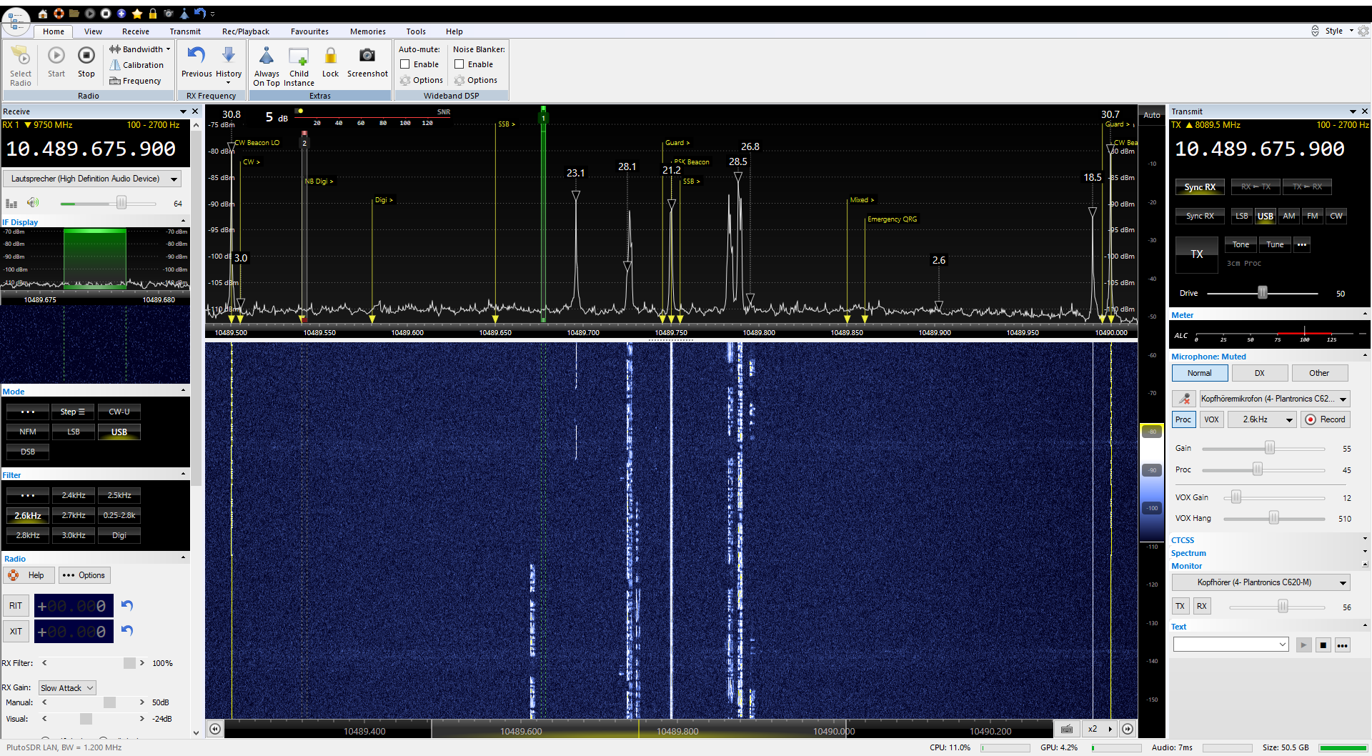

After some hours of operation, the (virtual) memory usage grows up to 50GB and more (and keeps growing and growing). While RX and TX audio keep working without interruptions, the UI reaction gets noticeably slower. Physical memory usage stays at ~3.5GB.
I noticed this for a few times, but as it does not happen each time I launch the console, I currently cannot describe a way to reproduce the issue.

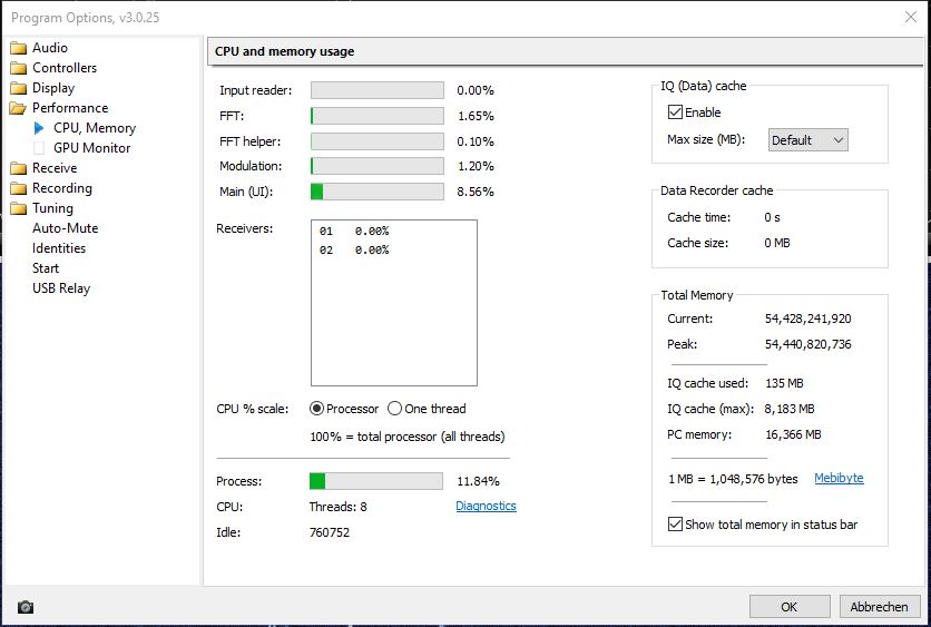

Pluto via LAN is my only current use case, so I can't tell if this happens with other configurations as well. I forgot to attach the logfile, here it comes. Virtual memory usage was at 50GB after some 9 hours runtime.
From memory, the console was running for 2 or 3 hours before I noticed the increasing memory usage. At that time, the current total memory usage dsiplay in the options window increased by ~1MByte/sec.

Thanks, it's losing ~ 1.5 MB/second.
