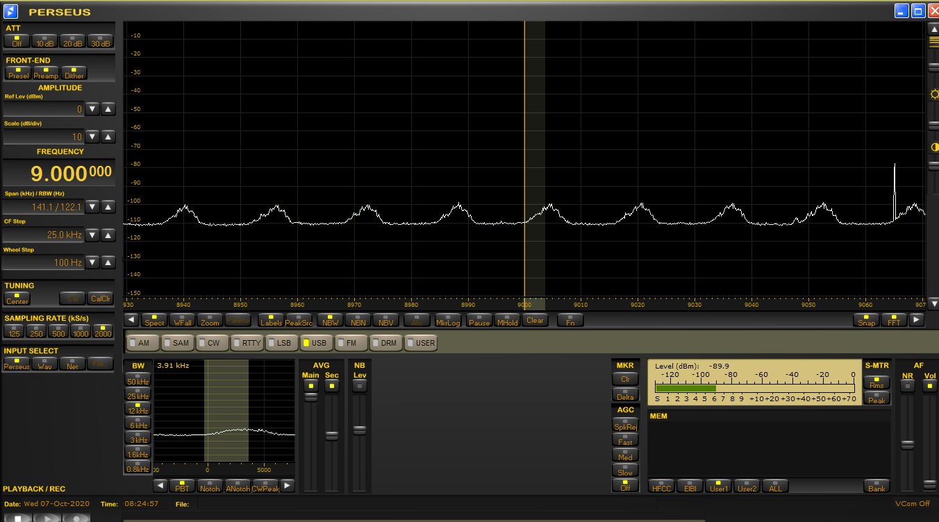

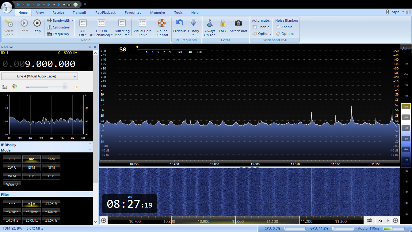

I could sure use some help trying to identify as shown in the attached pictures. This interference occurs in the 2 mhz, 7-10 mhz, and 16-20 mhz bands and to a minor amount elsewhere on HF.
I have had this problem before. I have walked the neighborhood with a portable Sony SW receiver. On house (3 away from me 250 feet) seems to have interference when I am in their yard. The young guy basically refuses to help out. I have talked to him in the past very nicely. He won't even answer the door.
One picture is from SDR Console using my Elad S2. The other picture is using the Perseus. my antenna is a 1-meter diameter Wellbrook loop in my back yard.

Looks like a psu of some sort, possibly a cheap charger.

Cheapo smpsu..
Phone charger etc
Try to null out with your loop..
If that fails build/ buy a noise phaser
If all else fails move to a ship on the sea..sorry thats not ment to be nasty..but welcome to 2020..

Yep, thirded.... cheap far-East manufactured noisy SM power supplies of any sort of which there are loads in close proximity either in your own home or those of neighbours as they come with practically every plug-in device these days.
Also poorly filtered UPS of some sort can be awful culprits. I had a Belkin unit 1200 VA unit and it was atrocious. Now replaced with CyberPower unit which is totally RF silent (actually I now have two they are so good).
Is it there day and night? If only daytime, then possibly solar power inverters?
