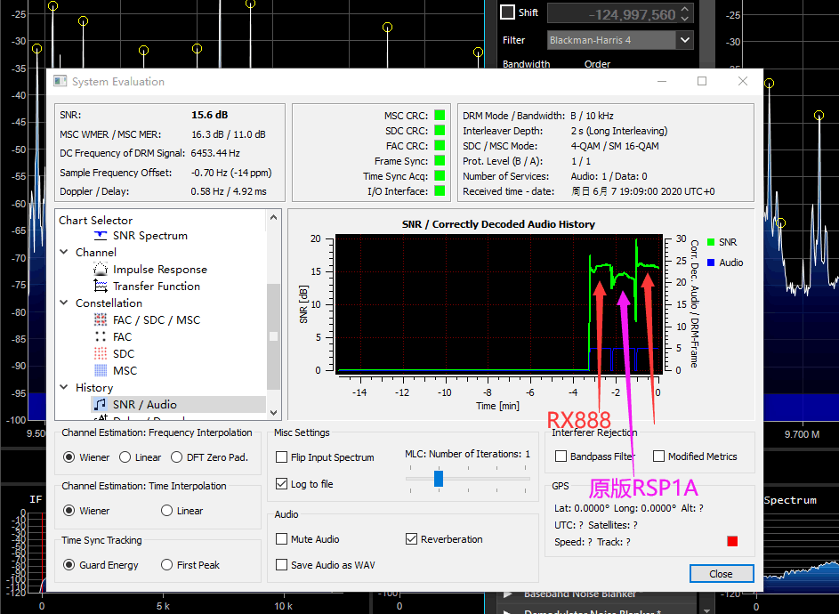

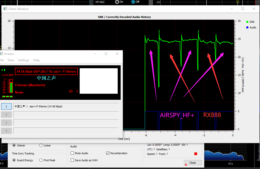

In fact, I found that the UHF effect is not very ideal. It may be related to the sensitivity of the R820T2 itself. I have compared AIRSY R2 with RX888. R820T2 performs better on R2. We tried to set the internal IF filter bandwidth of R820T2. But it seems to have no effect?
But the RX888 effect is very good in terms of HF effect, better than the official SDRPLAY 1A in my hand. Although RX888 only has a 64M LPF filter, it shows a better SNR value when receiving the same DRM signal.
