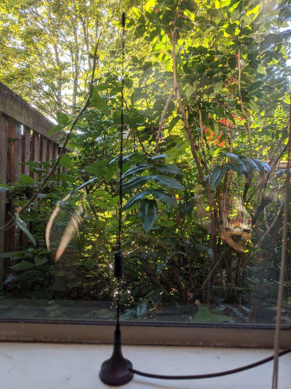

Being a paranoid sort please post a picture of the connector showing the front of the connector at about 45 degrees. (coax cable to the rear more or less.) I've had people get confused about what makes the connector male, protruding white insulation cylinder or the protruding pin. I suspect you know what you are doing. But, having seen the error before and who it was who made the error....

Yes,
It has a pin in the center of the connector.
- photo_2020-10-09_12-37-05.jpg (12.56 KiB) Viewed 7121 times
Re: SDR Starter problem
And at the angle you are holding the connector there appears to be no damage to it.
I forget if you've mentioned it above - have you measured center conductor and shield continuity and an open circuit center conductor to shield?
You are not using a bog standard typical rtlsdr dongle. You might want to try to reconfigure for the I channel. Personally I never bother to use an rtlsdr dongle on HF. I don't know how Simon has his software configured for direct sampling modes. The rtlsdr HF coverage is clumsy and full of problems. Another thing you might want to do is use the 2,400 ksps sample rate setting and tune to 1.5 MHz on the display center.It should cover the broadcast band and more on the top end - if it works. It MAY be that you got a dose of Chineseium there, too. Or it may be an up-converter based tool with an unknown up conversion frequency. I notice it is labeled to work 25 MHz to 1.7 GHz on one port and 100kHz to 30 MHz on the other. I predict you'd be disappointed in its performance down at 30 MHz on the VHF/UHF input, too.
