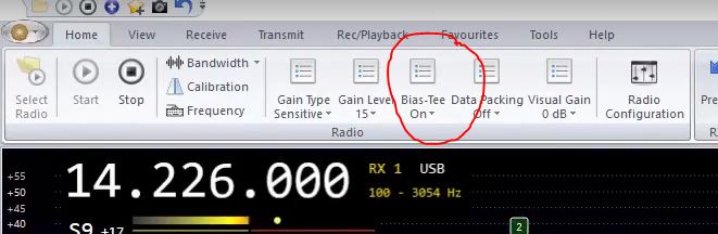

I don't have R2/Spyverter but according to this YouTube video it's in the usually expected place on Home tab of the Ribbon Bar? See button top left about 1/4 way along ribbon bar in "Radio" section (play video full screen to see). Also see attached picture. Assume it's still there in latest versions of SDRC?

I am using the newest version of SDR Console. I have loaded the definitions from the list like it is required. but none of the R2 radio options show up on the Home tab.

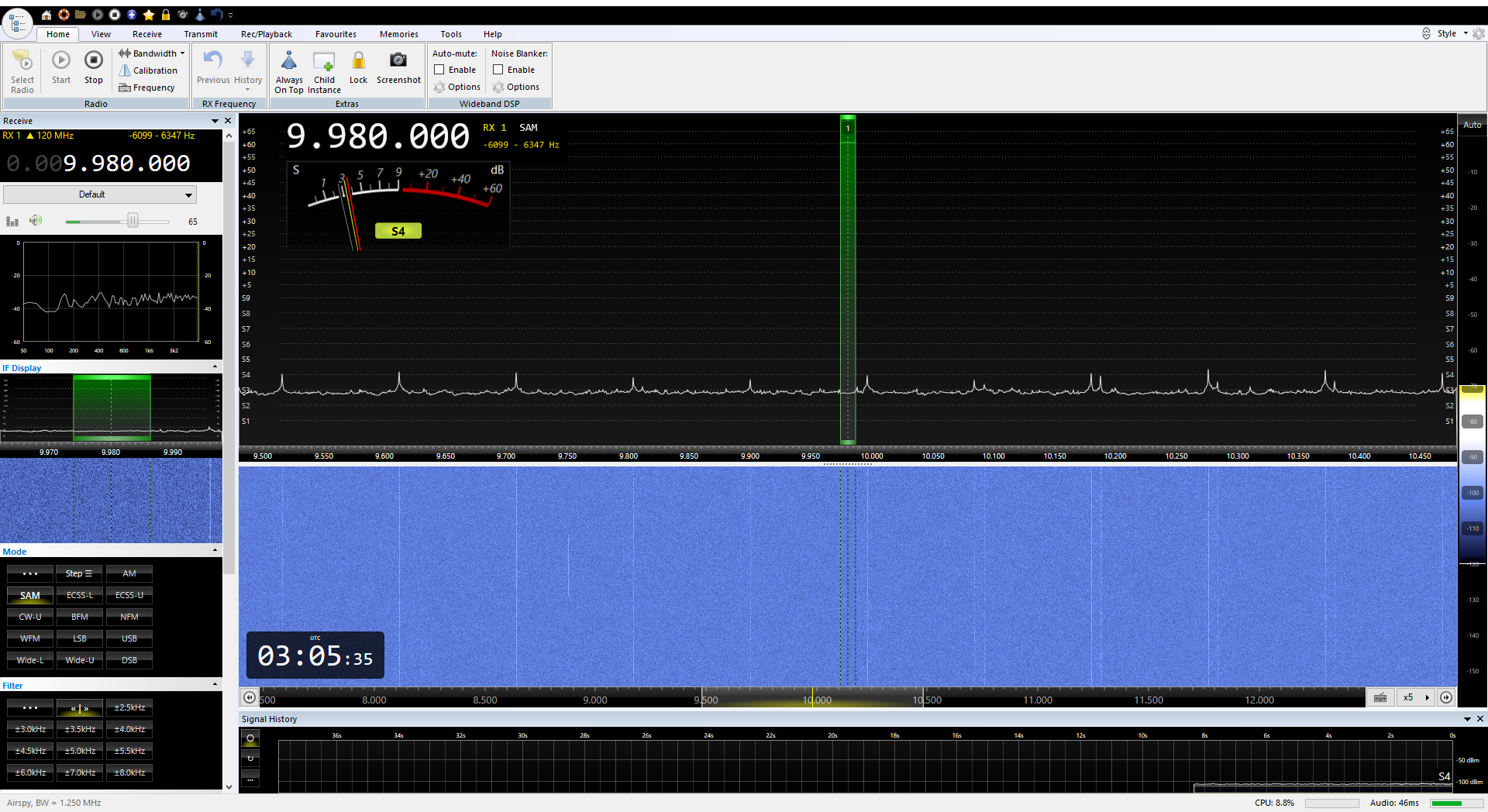

Scroll down the receive DSP (left hand side), you see 'Radio', Bias-T is there.
