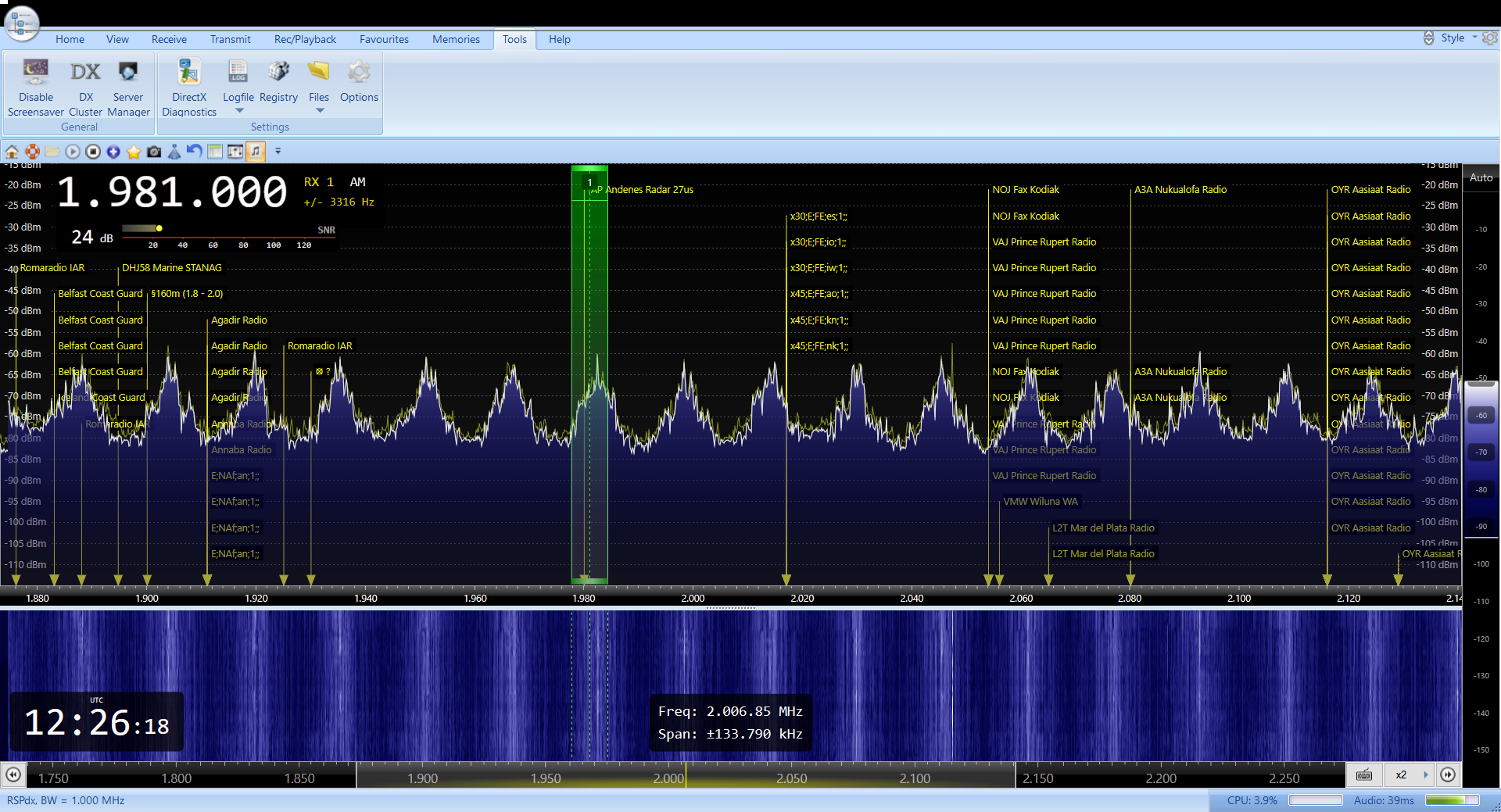

Hello Bob, please make a FULL screenshot in SDRC of that 2-3 Mhz range (if possible wider) so we can see how the noise looks like.

Assuming it works, here's a photo of the "noise" I am trying to peg.
Please let me know if it doesn't show (anywhere).
I'm still a bit uncertain re how to Attach or include photos.
It's pretty much exactly the same from 2 to 3 MHz, AM, all the time.

At risk of sounding repetitive (I've mentioned it in quite a few interference threads) I had something very similar, at about same frequency, and it turned out to be my UPS sitting right in under the computer desk. I had not really suspected that even though I had done tracking exercises before. Surprised me as I thought all decent brand UPSs would be well filtered. Seems not. Well known brand. Belkin. So if you have a UPS try turning that off (totally, on switch and unplug from wall).
Must say that does look like a very nasty case though. Many interference sources do turn out to be in our own home, so the first thig to do is fire up a laptop (on battery of course) to run SDRC on, then shut off all circuits at the main "consumer unit" where main power enters the home. Then, turn on individual circuits one by one while monitoring the result. In my case when I have done this I have (1) yes, found some sources of RFI but (2) also been a bit disappointed that it is not all from one source, but a general raising of the noise level as each circuit goes on, but yours is so identifiable that it should be easy to trace.

Another common source of noise is from USB cables. I recently discovered my Canon printer was making a racket due to long USB cable and no ferrites. Disappeared when I turned the printer off. As I recall USB generated interreference often has an 8 kHz repeat interval (not sure why). Not the case here for you, and anyway those "spikes" are very broad (just like my UPS ones were), whereas the USB 8 kHz spikes are very narrow (in my experience).
