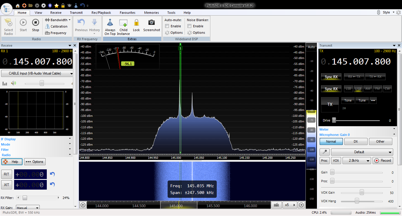

Now that my start/stop problem is solved (thanks excellent Forum!) I have another issue to bother you with.
Same Pluto, but older lower performance PC.
The issue is a spectrum/waterfall that has lower bandwidth than expected. As far as I can see all settings are the same as work on my higher performance machine, and I have changed away from Manual gain. Attached are screenshot and log file. [Both were captured when RX gain was set to Manual, but changing that does not affect the issue with this PC.]
I have tried all 3 available USB ports with same result.
When the radio starts, briefly the spectrum is wider but then settles to that shown in the screenshot. Could this be just very poor USB performance?
I haven't tried powering Pluto externally yet, btw.
Charlie G3WDG

Hello Charlie,
Your screenshot shows the "RX-Filter" slider set to 24%. Please try setting this to 100% and you should see the entire 500kHz as selected by your bandwidth setting. (Apart from some inherent dropdown at the bandwidth edges).
73 Jean DJ0VL

Hello Jean
You saved the day again - many thanks!!
Second PC now working perfectly. Not sure how that slider got adjusted - probably finger trouble here.
73 Charlie G3WDG
