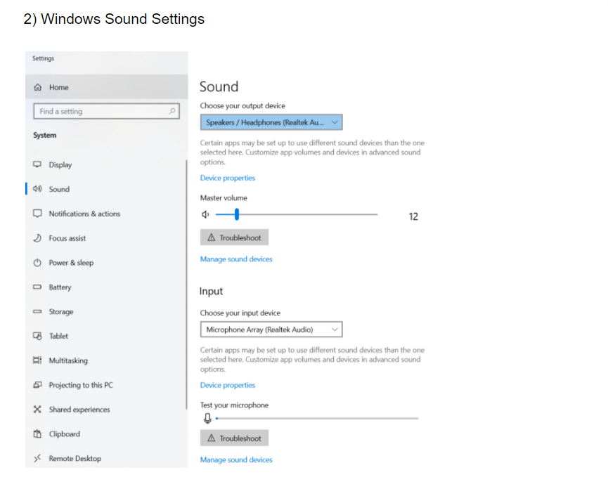

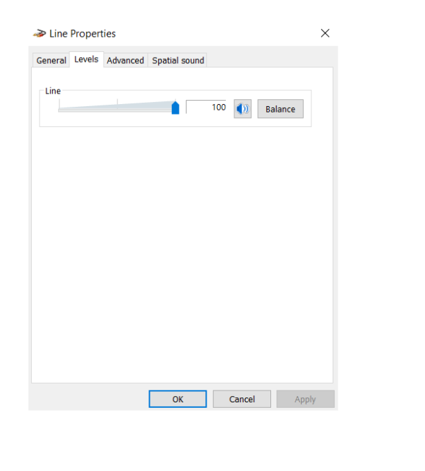

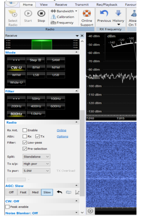

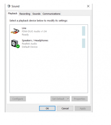

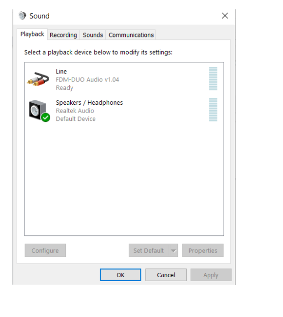

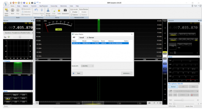

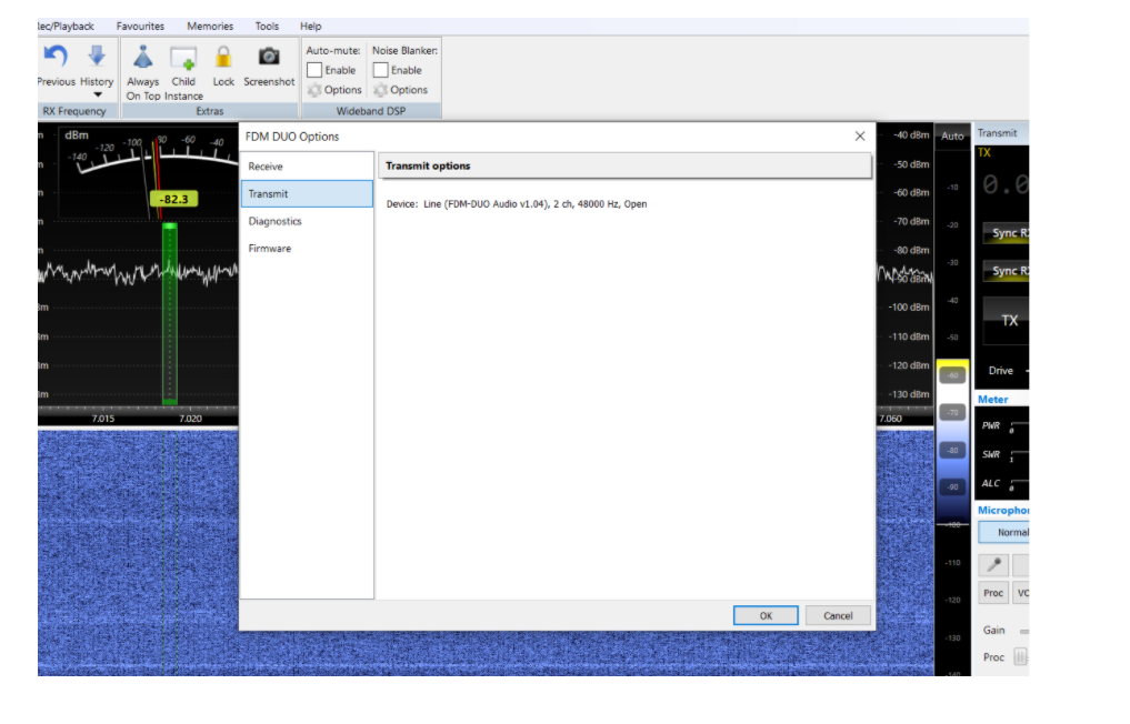

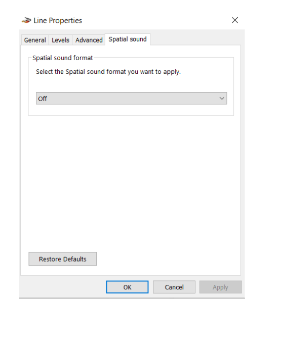

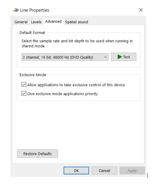

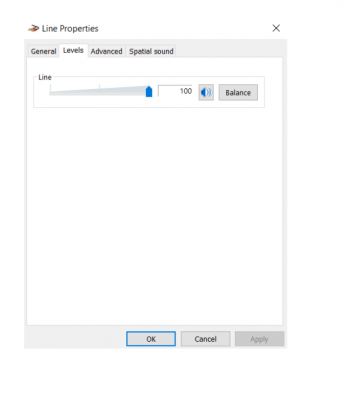

Here are all my settings. I have checked an when I click the Tune button in the TX Pane, the radio relay goes into TX, but no RF comes out...

Remaining Screen captures of my settings:
Perhaps I need more clarity on how the entire windows sound settings need to be set up???
Thanks for all your help.

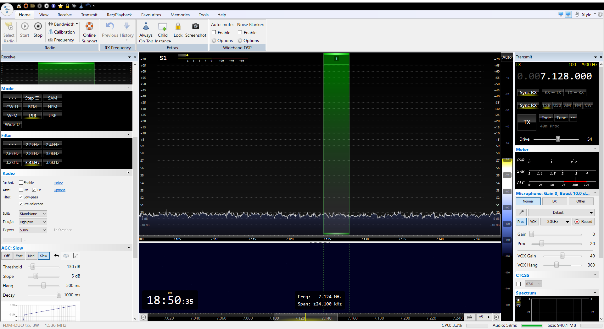

Re: Can not xmit
#17

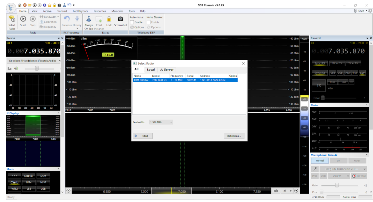

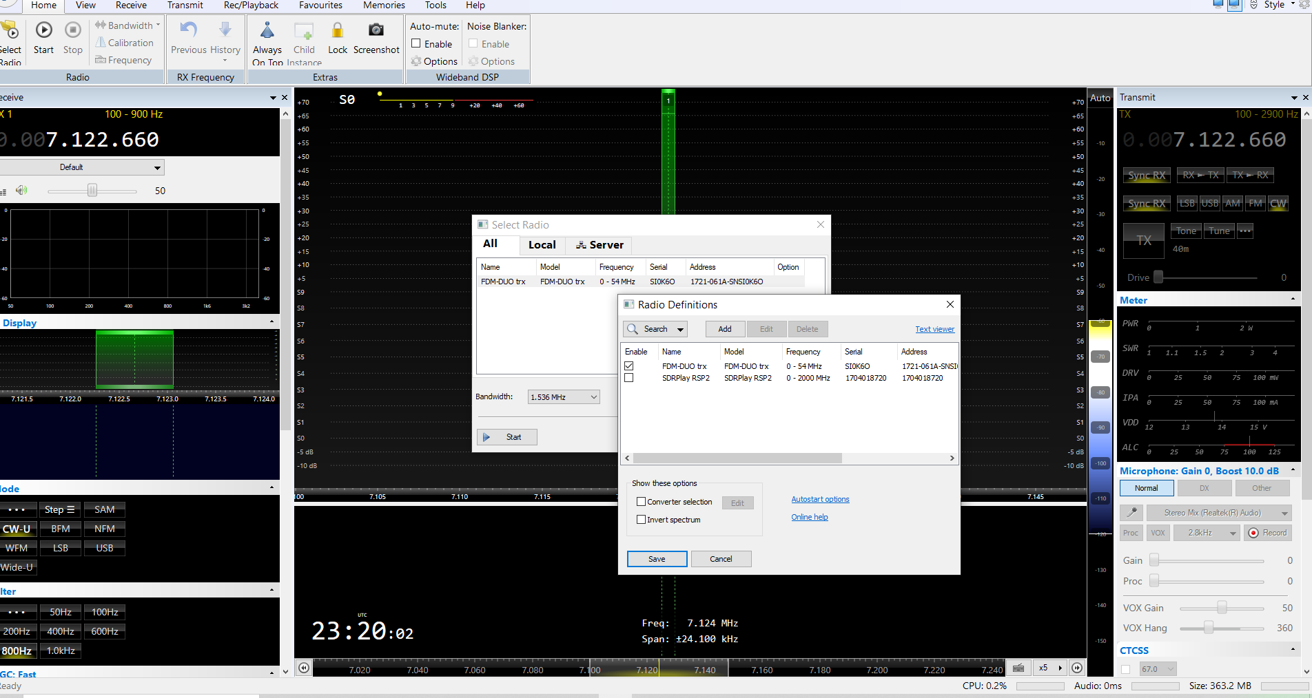

Start the Radio. Take a screenshot of the whole console, I'll annotate what needs doing. No other windows opened please.
NE7EE
Posts: 7
Joined: Mon Nov 16, 2020 1:07 am
Re: Can not xmit
#18
Unread post by NE7EE »
Here is the screenshot.
Thank youi!
Re: Can not xmit
#19
OK,
Transmit Pane (RHS)
  • Increase the Gain, 90% is good
  • Spectrum (slightly obscured) will show your TX waveform. Click the * and O buttons for different formats.
  • You have 10dB boost, it maybe necessary to add a bit more, just depends on the microphone.
  • Select the microphone - you're using the Default atm.
  • When you click Tune remember you must increase the Drive.
  • Make sure you've set the master gains.
Let's see how far this goes...
