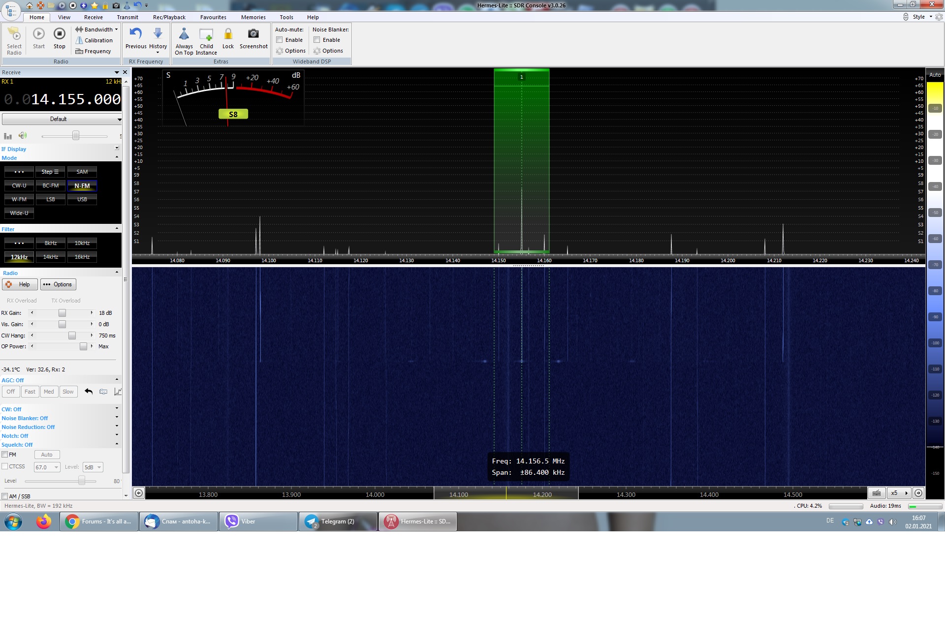

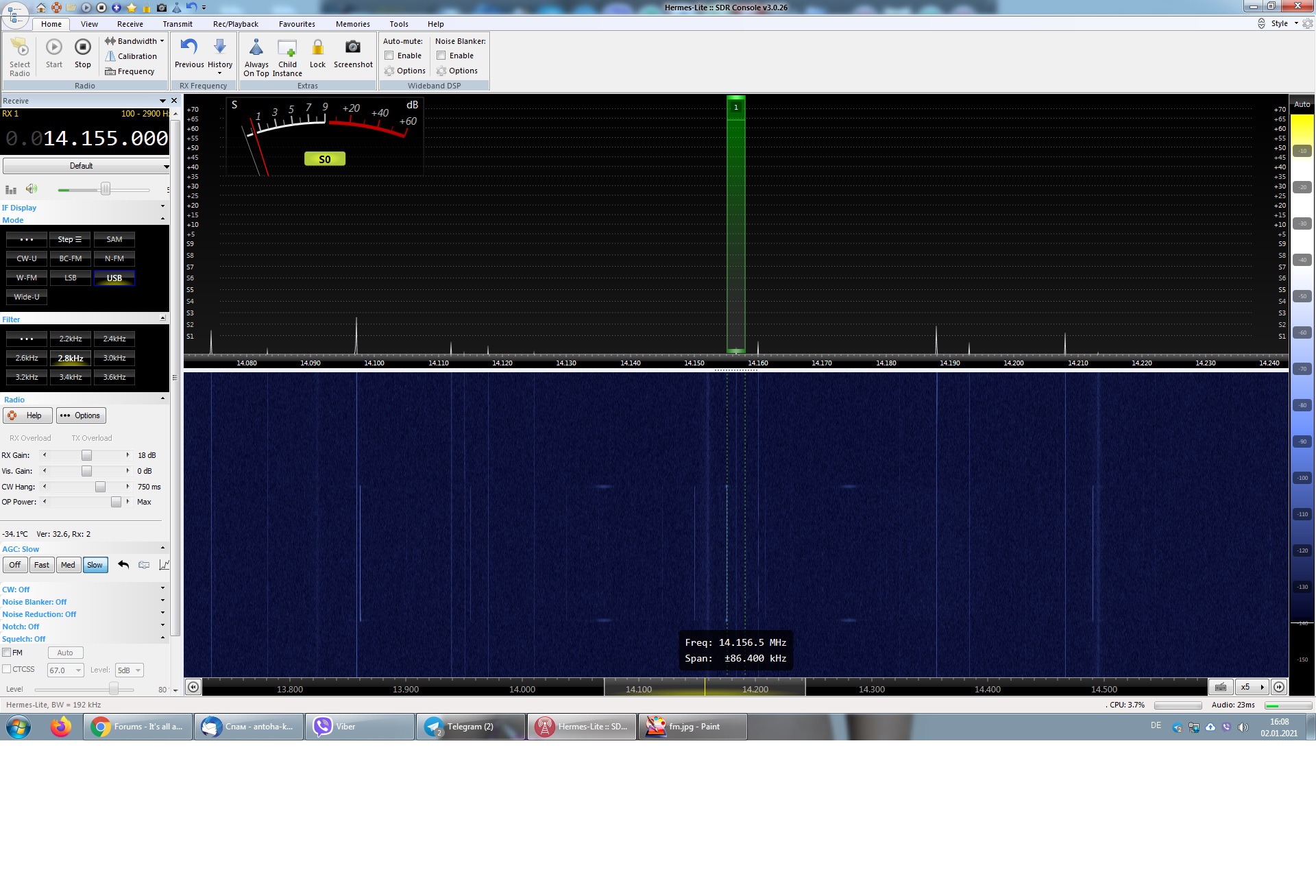

Hello, there is a problem with FM/AM modulation and Hermes-lite hardware. As on screenshots see, there is a carrier appears at the monitoring frequency if FM or AM modulation is turned on. The bandwidth is not affected.

You are showing USB at 2.8 kHz on top and NFM at 12 kHz on the bottom. xSB and NFM have completely different bandwidth selections. USB has no carrier, as should be if TX is enabled. NFM has carrier, which should be if TX is enabled. Perhaps you could show your Transmit settings.
