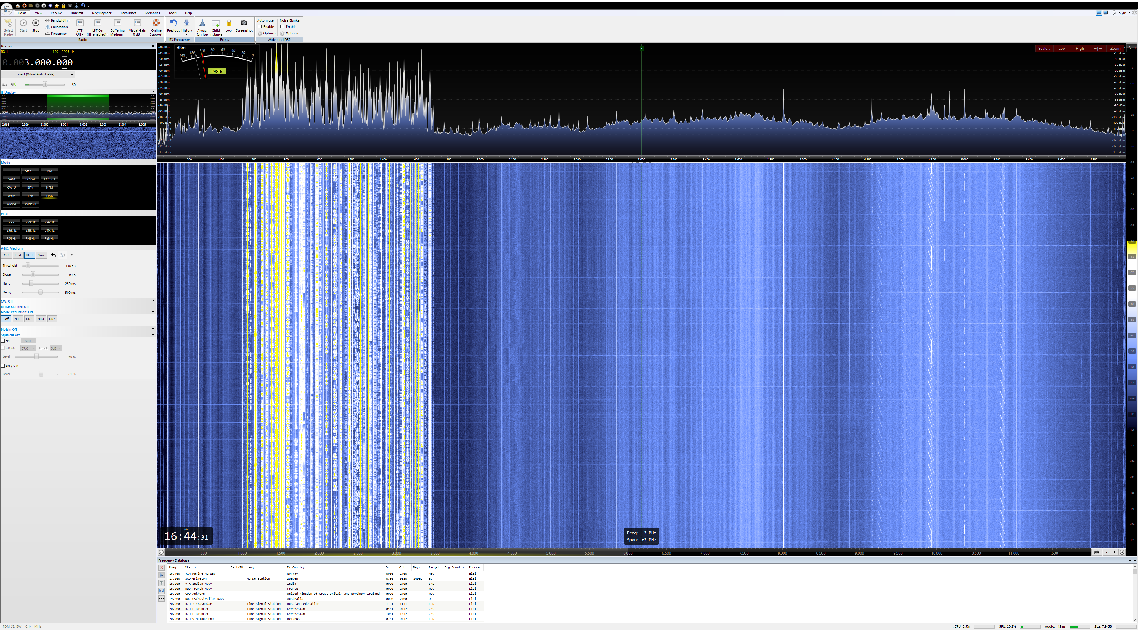

Here's a screenshot of the whole 6 MHz. Setting the S2's BW to 6 MHZ works, but everything is noisier than when it's set to 1.5 MHz.
@Paul: Yes, this also happens with FDM-SW2.

W6UV wrote: Mon Oct 05, 2020 6:08 pm Here's a screenshot of the whole 6 MHz. Setting the S2's BW to 6 MHZ works, but everything is noisier than when it's set to 1.5 MHz.
I think your problem is the *very* strong MW signals. To receive properly above 2MHz you may need a HPF.
Please adjust the display so the peaks of the strongest signals are visible, at present they are cut off.

Also,
A difference between the 6MHz and 1.5MHz bandwidths will be ~12dB less dynamic range with 6MHz compared with 1.5MHz. This may be the problem - those MW signals appear to cause you some serious problems.
