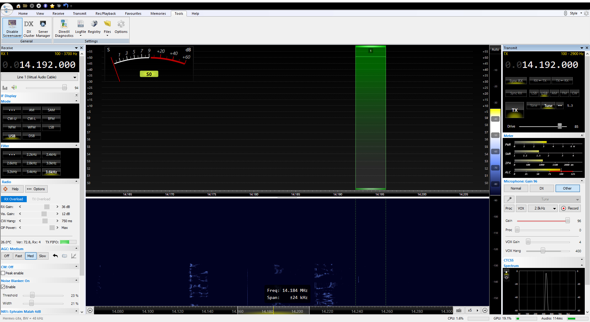

Hi Karl
I cannot see the issue in any of the screenshots:
Screenshots:
1) You have Tone selected, but you are not in TX mode (have not pushed the big TX button), i.e you are still in RX, so no power output as expected.
2) You have "Tune" selected, and there is output power (normal behaviour)
3) As per (1) you have tone selected, tones are present at the audio input (seen on spectrum and can be heard by pressing "RX" audio monitor in the TX DSP panel - monitors audio input, but when in RX mode) but again, large TX button has not been pushed, so you are still in RX.
4) All exactly as per (2). You have Tune selected, and the HL2 is in TX and has power output.
Or are you saying that in the two screenshots where SDRC is showing output power ("Tune" mode), none is measured on output of the HL2 with a power meter?

Max,
Yes, you're interpretation of the previous screen shots was correct. Yes, I can get RF out now when pressing "Tune" both with and without a Winkeyer being plugged into the PTT jack.
There was no RF generated when pressing "Tone" with either the Winkeyer plugged in or out. The SDR Console shows it producing power though. I am listening in another receiver and monitoring the power output on an external watt meter.
I've rebooted again and performed the "Tone" test again. This time without a Winkeyer in the PTT jack. I suspect what I've been seeing is related to having the microphone configured as a Virtual Audio Cable and not having a Winkeyer plugged in to the PTT jack.
1) If I press "TX" and "Tone", I get two peaks, RF output, and a single tone in the external receiver. There is a screen capture of this. [attachment=1]VAC as microphone single tone generated with RF.
2) When I attempt to exit the "Tone" or "TX" mode, the Hermes PTT cycles and transmits two tones. I can press "TX" and "Tone" repeatedly, but it continues to transmit. Also a screen capture of this behavior.
3) Short of turning the power off to the Hermes, the only way I've found to stop the PTT cycling is to mute the microphone configured as VAC or change the selection to "Microphone USB Audio Device" Screen captures attached.
I apologize if the screen caps are in the reverse order to items 1 though 3.
If I repeat the above with the microphone configured as "Microphone (USB Audio Device", there are no issues and everything functions as expected.
