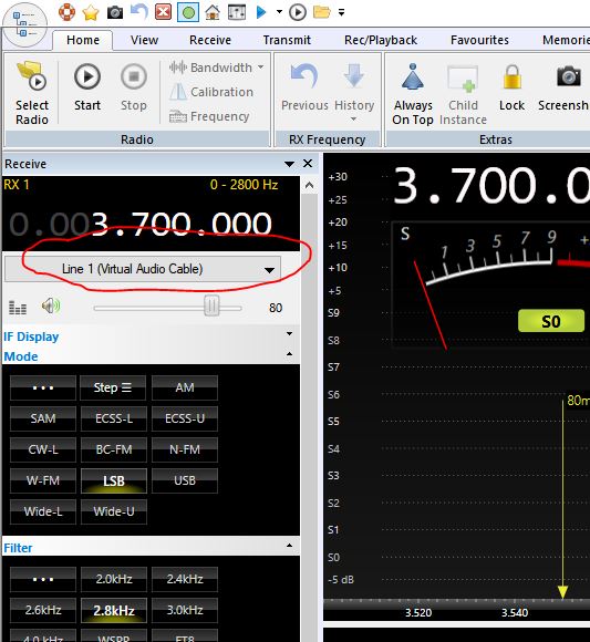

In the Receive DSP Panel chose the dropdown menu (see attached).
Barry

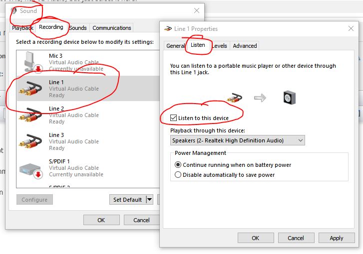

I've got VAC, not VB-Audio, but same principle, just select it here:
Then in Windows Audio settings, select "Listen" to be able to still hear the output in speakers:
To get to the last dialogue, press Windows key on keyboard to bring up Start Menu, then type "Audio Devices" (without the quotation marks).

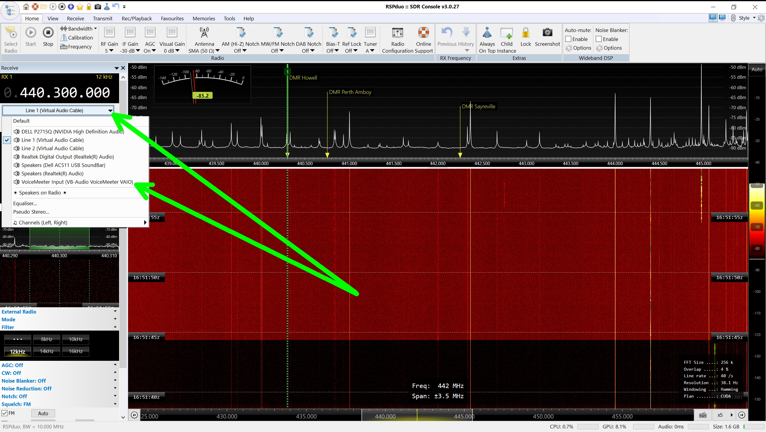

I'm also having trouble assigning VACs to different receivers.
I use the Receive DSP Panel to chose from the dropdown menu my VAC number.
Next, I click the + button to add the next receiver.
Double click it on the spectrum to select it, set the frequency, then from the drop down list, select the next VAC number.
Two important things to note - firstly, the little yellow RX number does not change when I double click between the two receivers. (It always shows RX1 - but the frequency changes correctly).
Secondly, both receivers now have the higher VAC number.
If I add a third receiver, same deal, the previous 2 receivers now how the same VAC number as the third receiver.
How do I get each receiver to 'honor' the VAC number I assign to it?

Assuming you have the most simple method (nothing wrong with that), and just the main spectrum window, just a single click on the cursor for the new receiver brings that receiver to "focus" and then you can select VAC of your choice in the RX DSP panel, and this only affects the "focussed" receiver.
If you have "Receiver Pane" enabled, then just hove cursor over the RX in question, then press the "Select" button that appears when you hover to select that receiver, then select VAC of choice.
