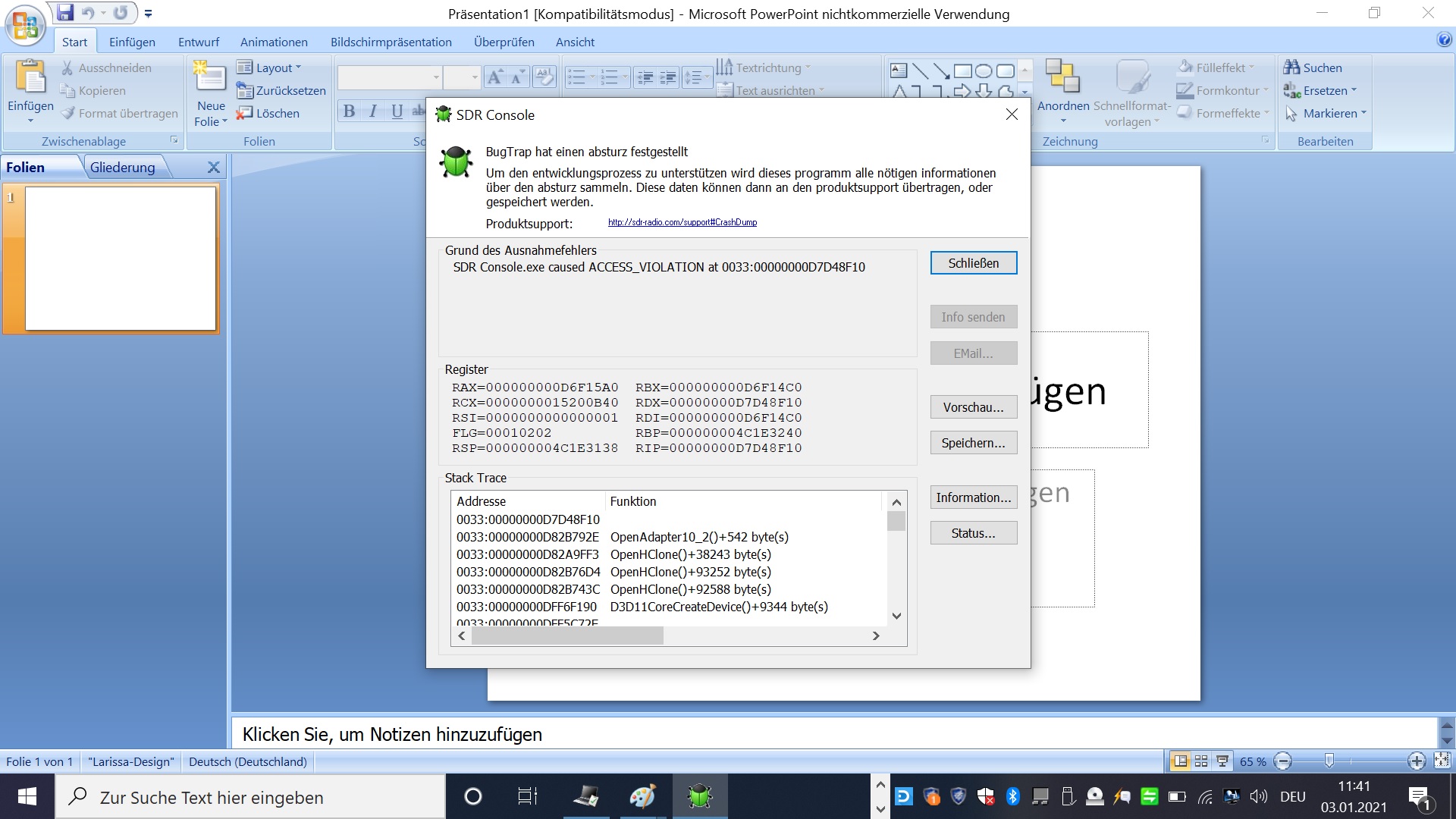

attempting to istall the SDR console V_26 I failed directly afte unpacking th install.exe version.
The SDR Console BugTrap reported the issue by naming a physical address area.
The installation issue appeared on an upgraded Windows10 vario tablet.
Is there any experience in that cicle to name this problem?

Sorry,
Looks like it isn't going to run on this hardware, it's not happy with the DirectX driver. I haven't seen this before.
https://www.howtogeek.com/258485/how-to ... n-windows/
I would like to see the DirectX diagnostics.

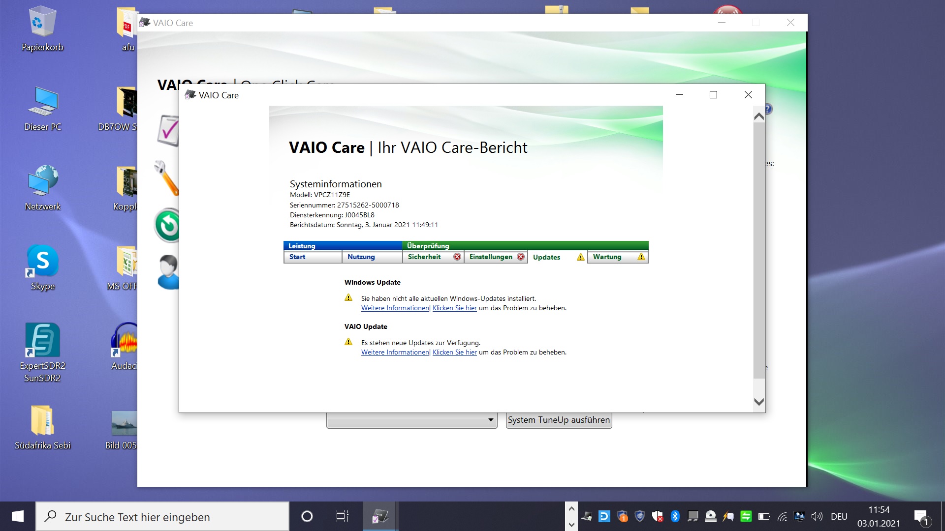

Andreas, pict 1 says that you have to update your laptop, seems to me that you have to start with that first... or am i missing something?

The update is done w/o positive results. The DirectX diagnostics I haven't made them yet.
