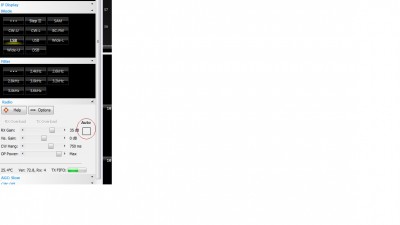

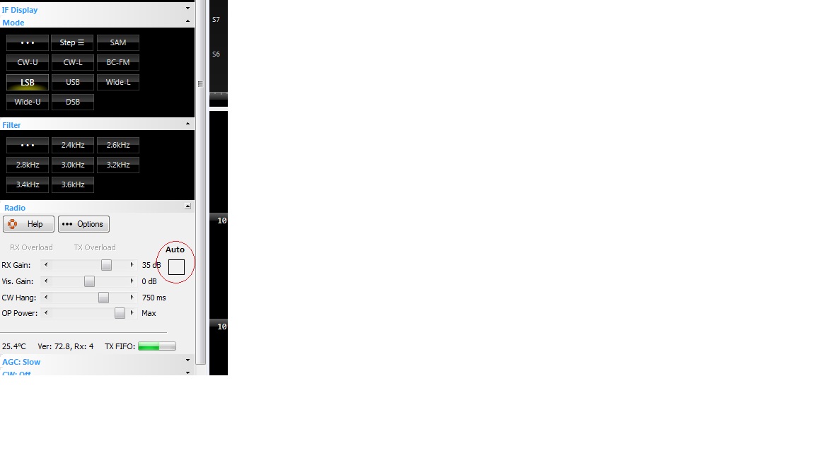

This is a request for a button in the 'Radio' section to set SDR-Console automatically controlling the 'RX Gain' level so that the rather modest 12 bit receiver a/d is served with the largest possible signal with only occasional overload. This level floats up and down a lot during the day. I notice this version of thetis includes auto-levelling to keep the ADC at optimum input.

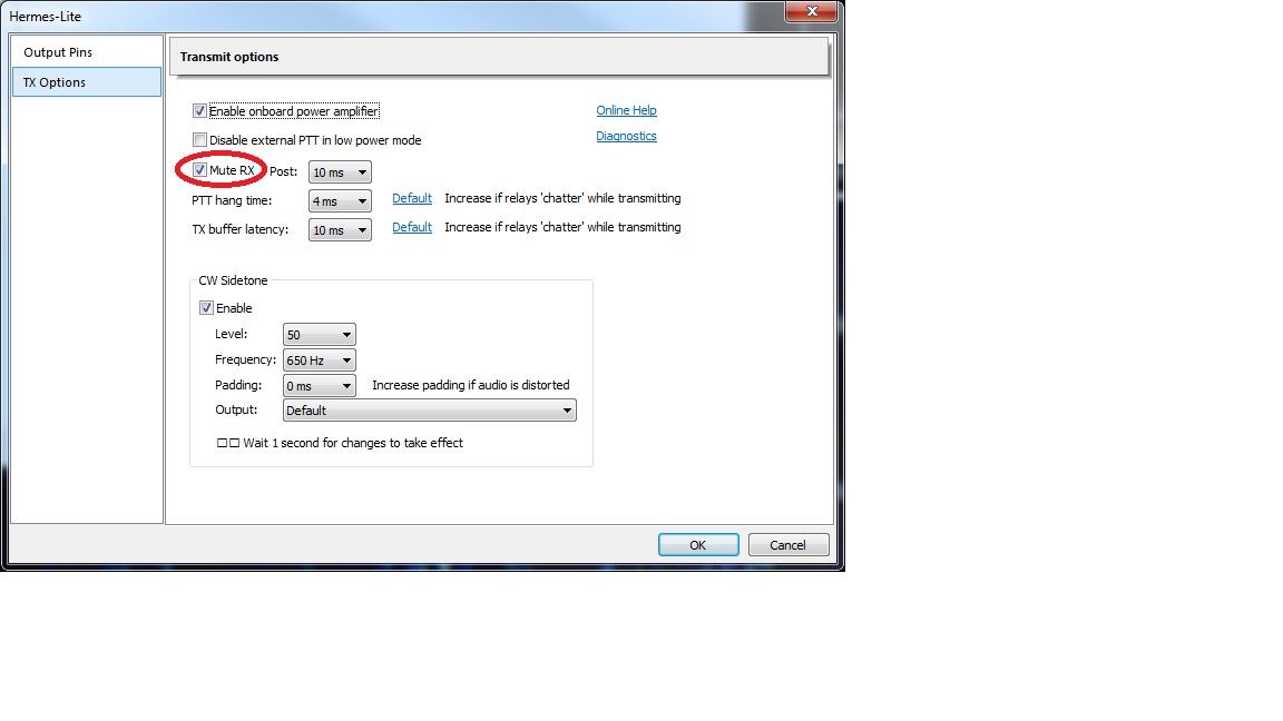

There are currently two 'Mute Rx during transmit' controls - one in the Hermes Lite Radio Configuration window:-

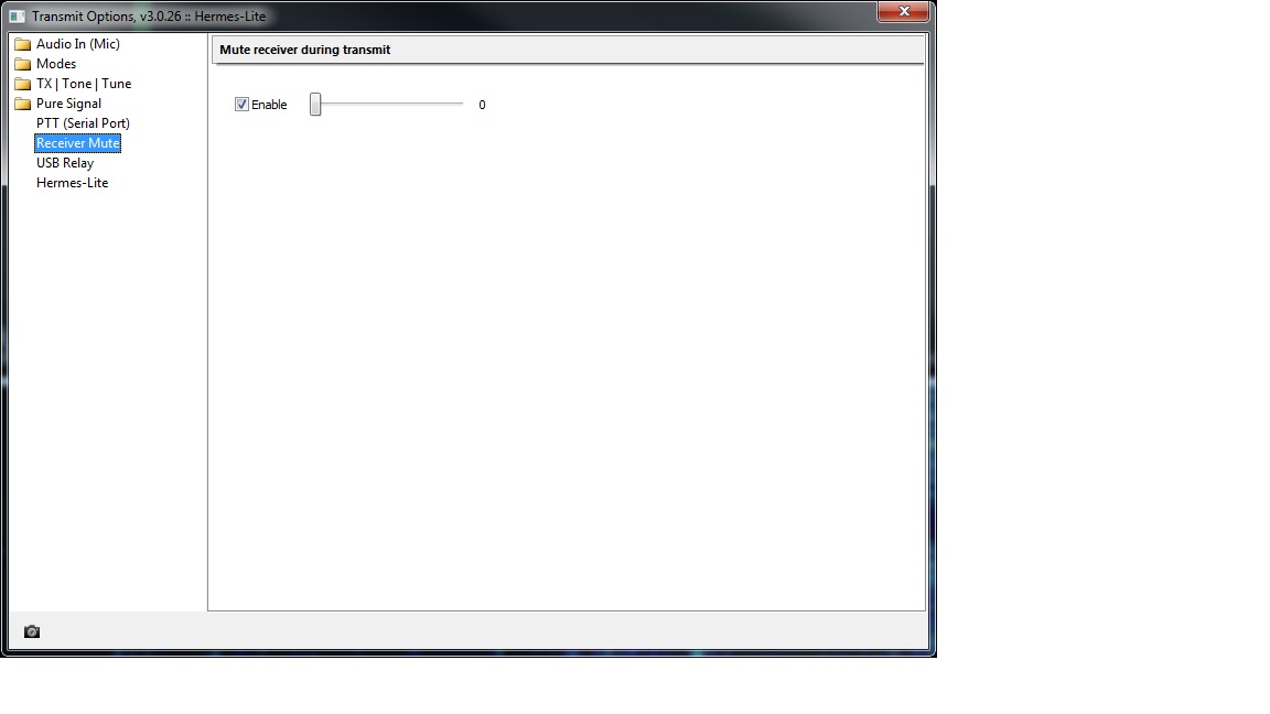

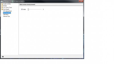

one in the Pure Signal feature, which is a variable mute:-
Both seem to work fine, but why two controls?
