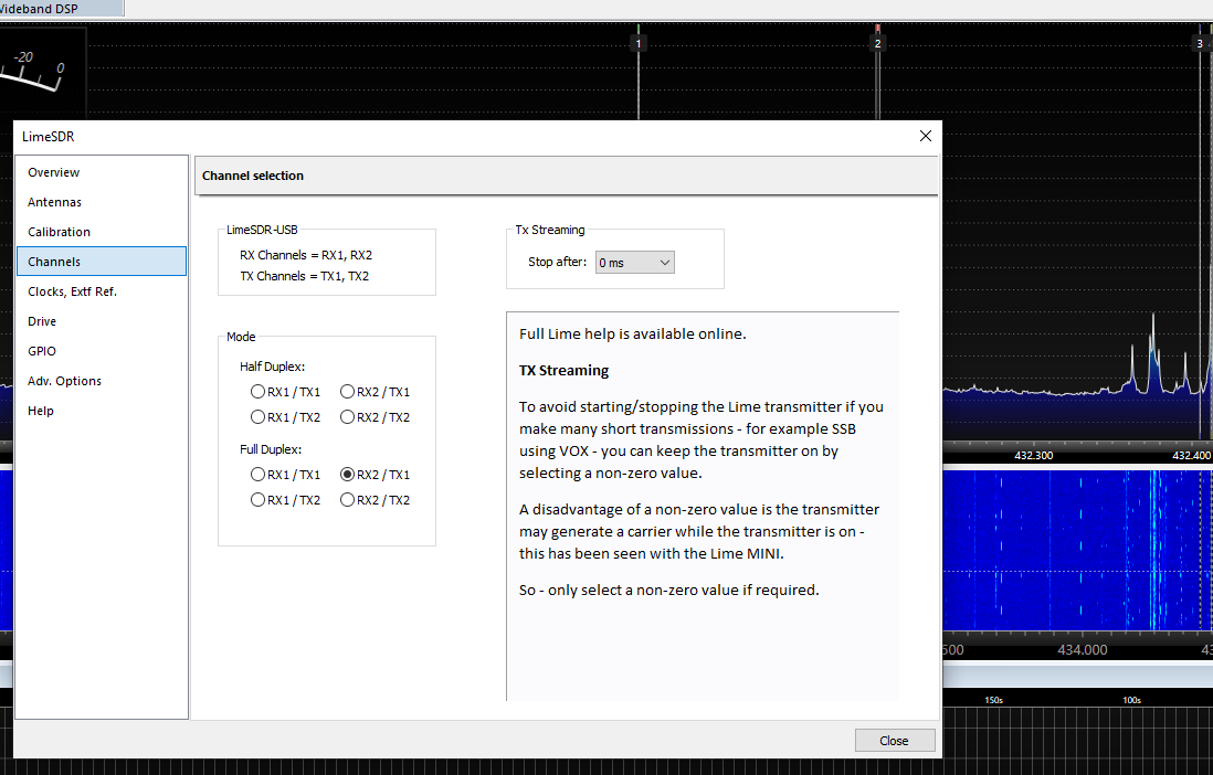

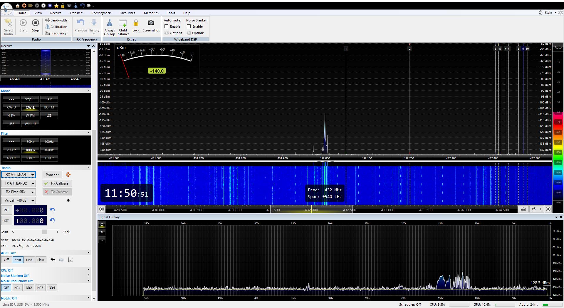

I can access all 6 Rx-ports using SDRC v3.0.27.
By pressing the 'More...'-button to the left in the LIME Radio-panel (see screenshot) you enter into a pop-up window and then chose the 'Channels'-tab (see screenshot) where you can chose between Rx-channel 1 and 2 and combine them with the wanted Tx-channel in half or full duplex.

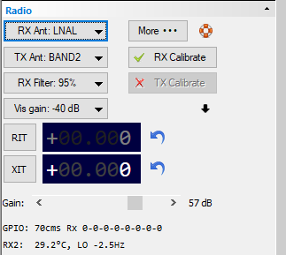

LNAL, LNAH and LNAW can be accessed by choosing from the drop-down list to the left in the Radio-panel (see screenshot).
By that you have access to all six Rx-ports.

What the LB1 and LB2 choice is doing is not known to me, for the time being. Maybe we can get an hint here on this forum with it's vast knowledge base.
