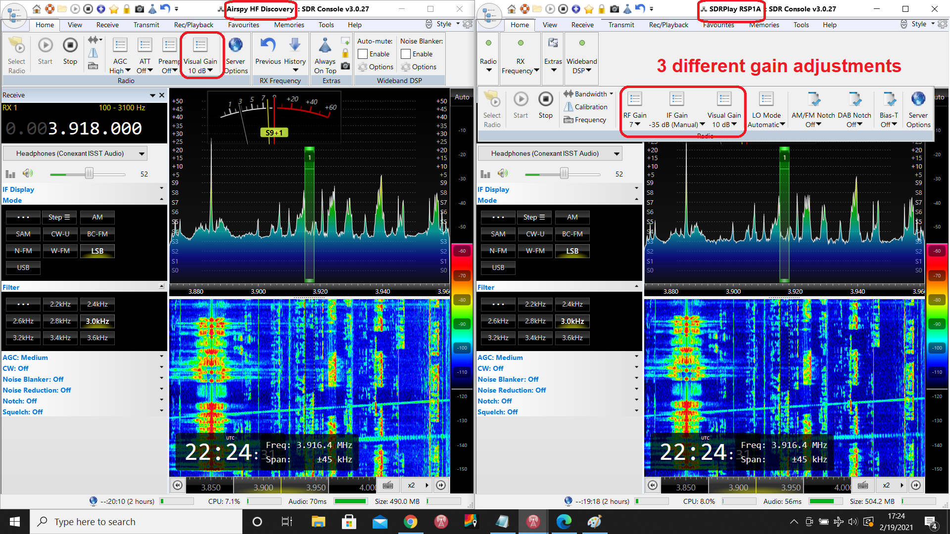

The Airspy Discovery is slightly more sensitive in the low frequencies (VLF up to 160m as I recall) as published on W1VLF's Youtube videos. You will find it WAY easier to operate versus the SDRPlay series when using SDR Console. The Airspy has ONE gain control (Radio AGC ON, Attenuator OFF, Pre-Amp OFF and the DSP AGC ON) where the SDRPlay has Three gains to fiddle with (DSP AGC ON). See attached photo of BOTH in operation at the same time.
In the attached photo, I was on KA1GJU Super Station #4. Running both the Airpsy Discovery and the SDRPlay RS1A at the same time. With much adjustments of the three different gain settings on the SDRPlay, I managed to get the two running almost similar. That server, because of the SDRPlay unit being hosted, has an AM BC filter in line to tame all the garbage that the SDRPlay will hear in the lower bands. The filter is from Paul, W1VLF's Youtube video and does a great job taming the harmonics and other images the SDRPlay would normally be plagued with.
So to answer your question, either one of the Airspy units won't let you down! As the owner/operator of 8 Airspy HF+ and discoveries, I highly recommend either one.
