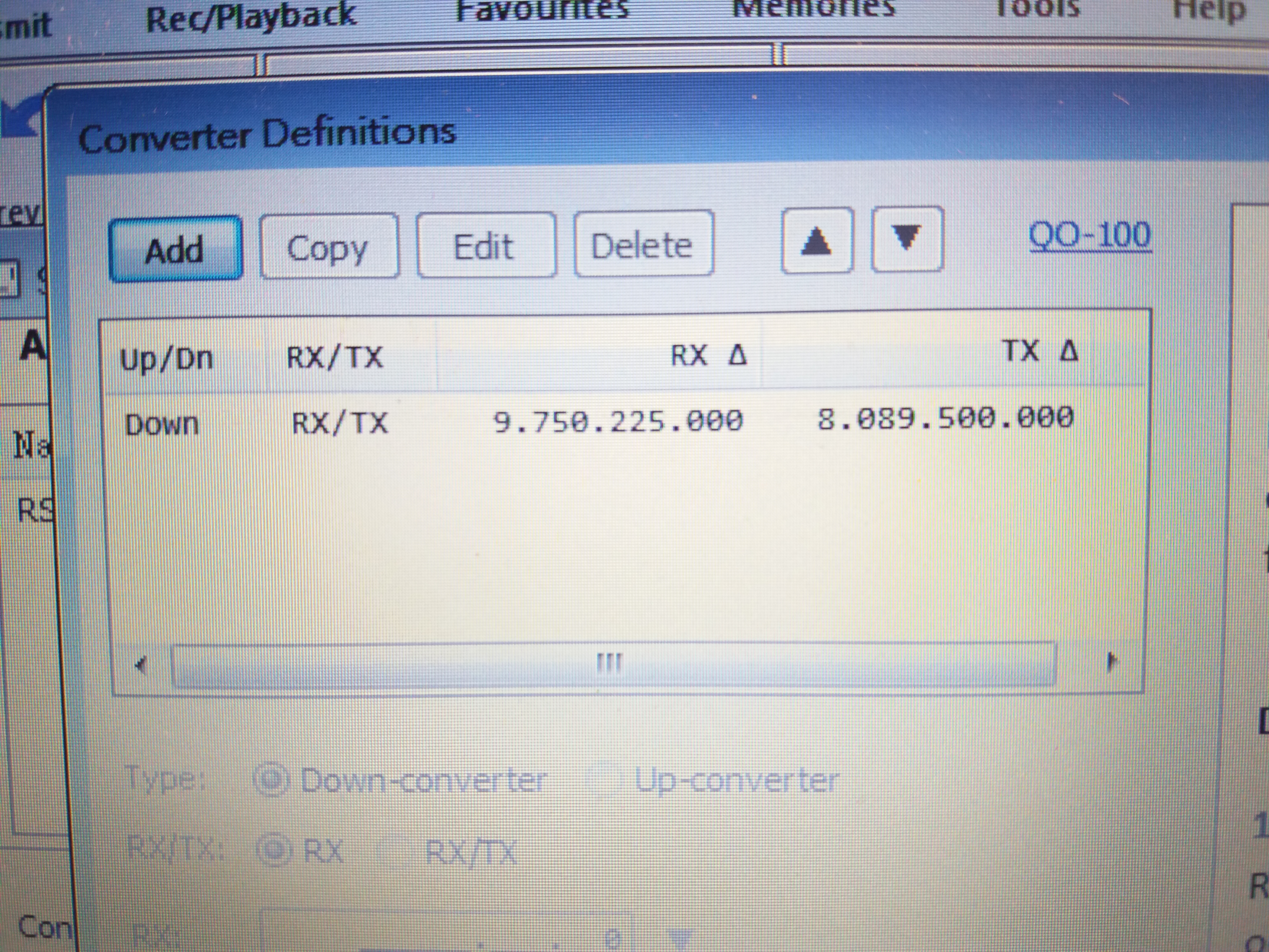

With qo100 beacon locked, is it true that the software will "auto adjust" value 9.750225000hz to an appropiate number to null out the "combined error of lnb lo and adalm pluto crystal"?
Now, in cw mode, if i send a carrier to sat, and receive water fall is, says, 10khz HIGHER than the dial freq. How can i manually adjust the 8089.500.000hz number (screen attached) to cancel out the tcxo error.
Should it be add or minus 10khz from that number?

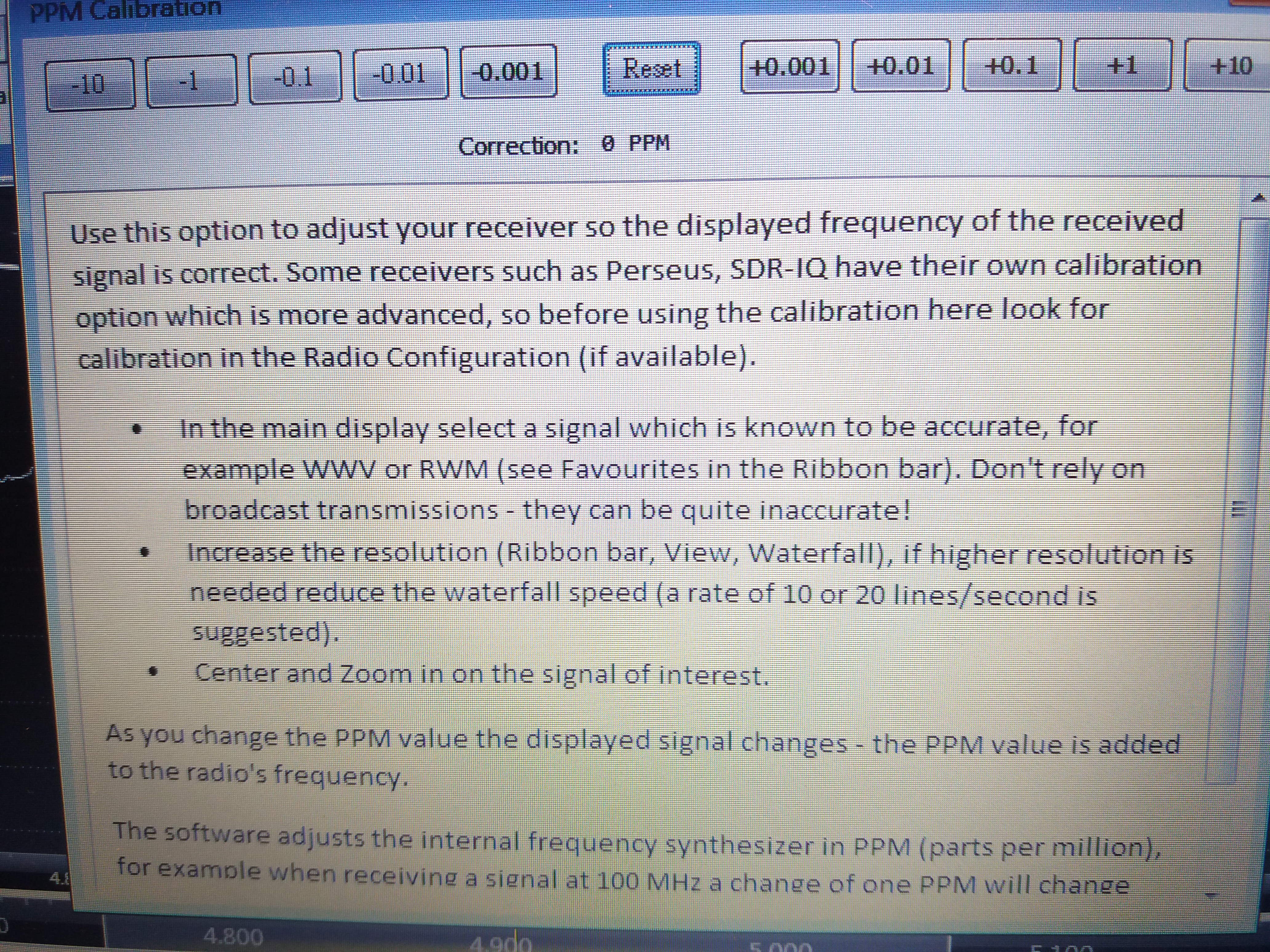

Is this perferred over the ppm adjustment? Screen attached
Given either of these adjustment method (ppm or no ppm), the freq are correct for the "average of the system error"

Re: How to null hardware freq errors
It cannot be done automatically, if that is what you are looking for. The bottom dialog will allow you to tune out the Pluto's error if you have a precise reference to work with.
