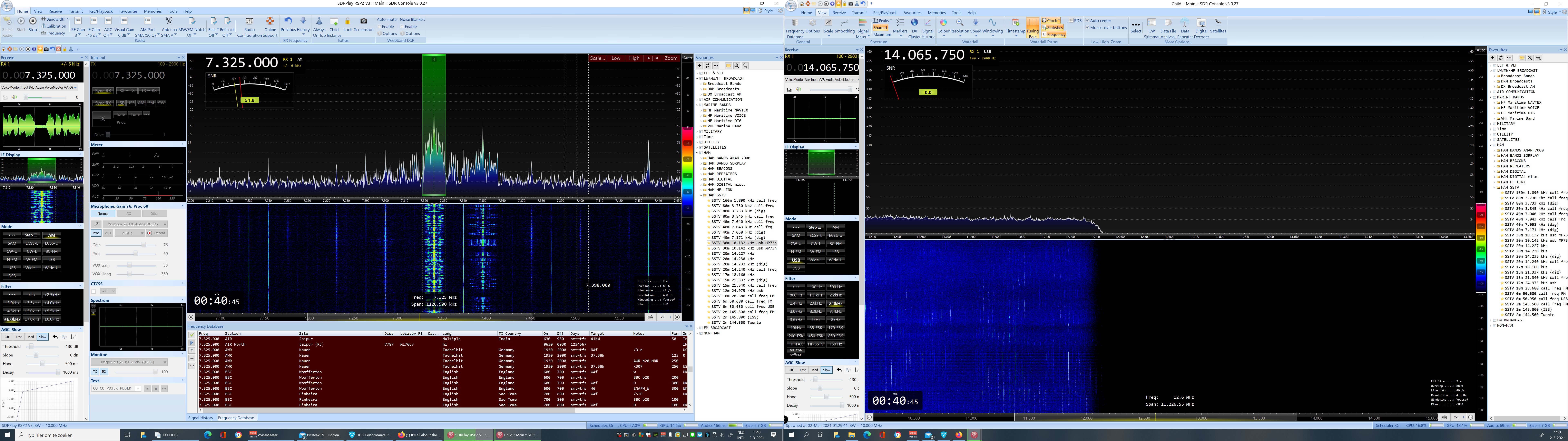

Hi, yes i'm aware of that but i don't think that's the issue here, i'm talking about a second SDRC instance as a Child process (by the CHILD button).
Btw the RSP2pro can show a full 10 Mhz iin SDRC.
To show what i saw,
- Start both instances with a max zoom-out, so showing 6 - 16 Mhz
- Tune the Main Instance to, say, 7 Mhz and tune the Child to, say, 14 Mhz.
- Then zoom-in in the main instance to show the complete 40m band (auto center is on). See the left part of the print screen.
- As you will notice, the Child will also zoom-in on the 40m band but the VFO stays on 14 Mhz.
Tune the Child VFO back to 14 Mhz, as you will notice, arround 12 Mhz the FFT and WF signals are not seen anymore (right part of the printscreen)
Just an observation, i'm sure it can be explained. If it's a bug then i'll replace this post to the right spot.

That indeed sounds like a bug and I suspect I know how it happened. It is a bit painful to prevent unless you handle it from the beginning in the design process. It bit me when I was building a debug tool for my partner, Loren. When it hit me that I have to reference back to the RIGHT CMainFrame ....
