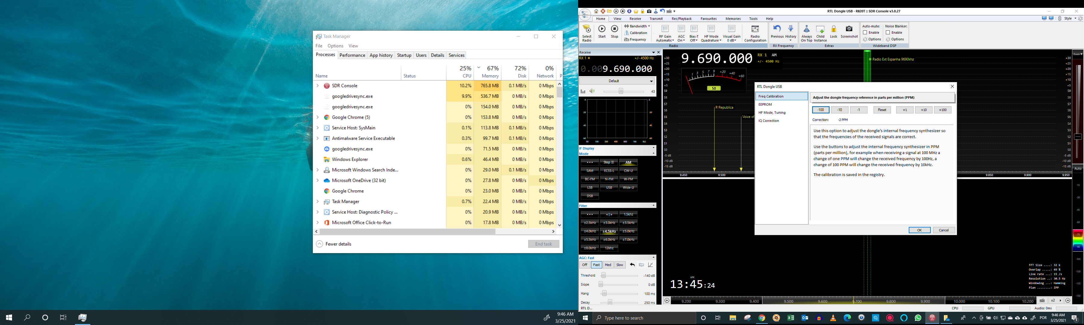

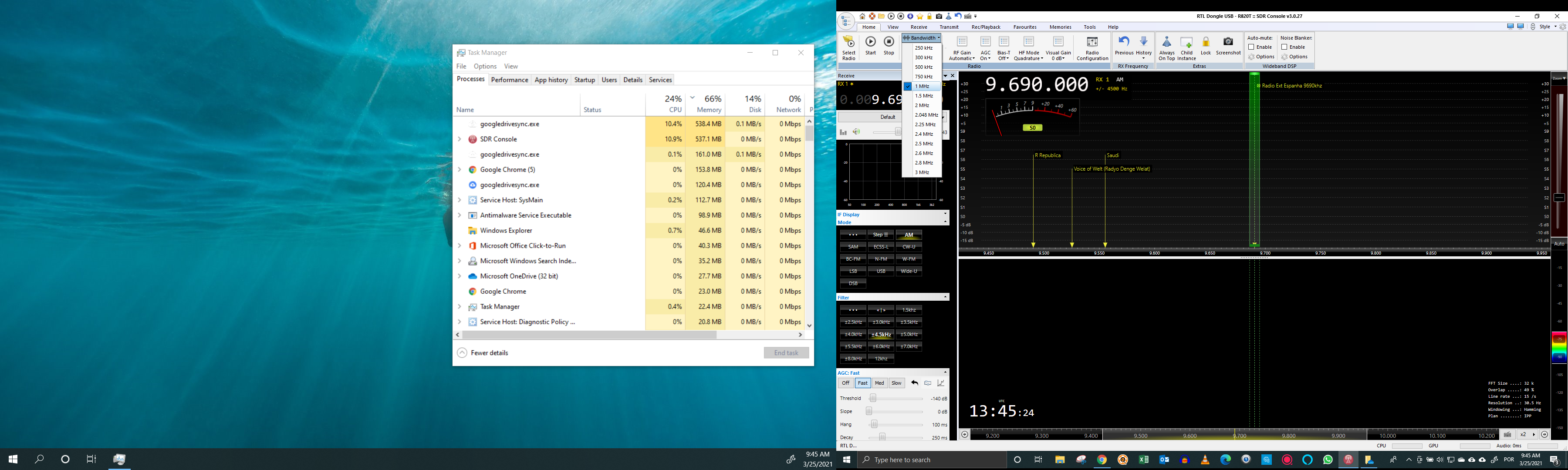

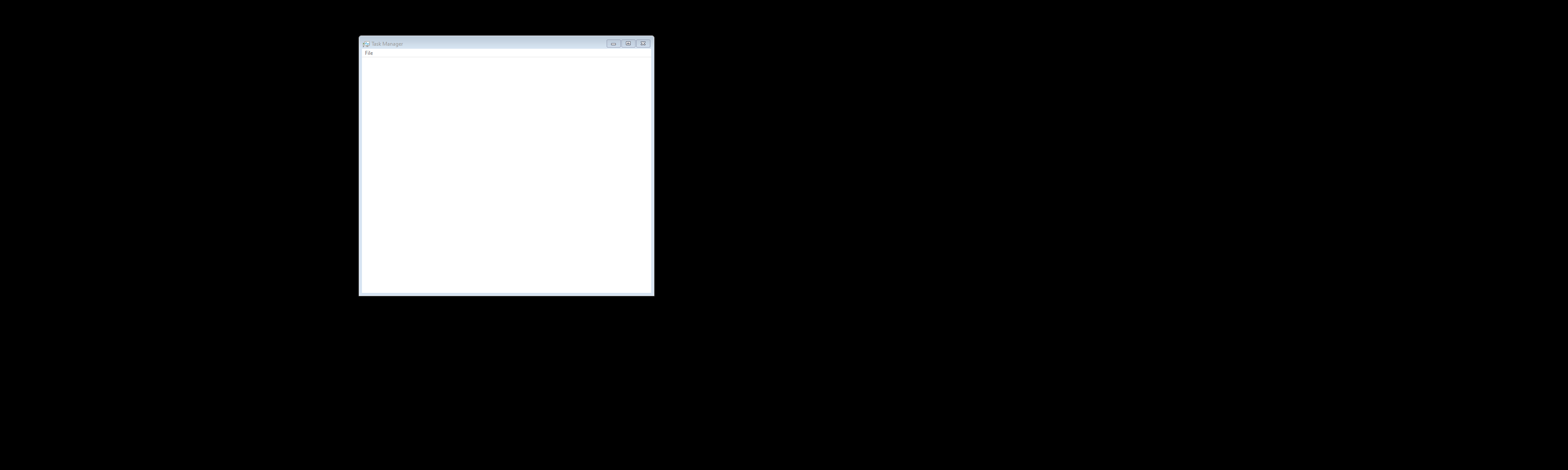

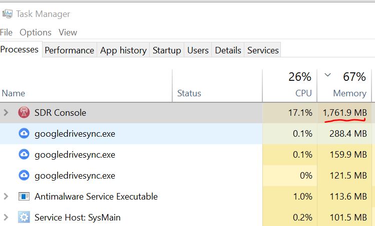

I was able to capture a sequence of screenshots until the GPU crashed.
You can also see the Task Manager screen open showing how the memory kept increasing.
The source is a RTL-SDR V3 dongle.
Bandwidth before was 2.4 MHz and then I reduced to 1Mhz and the issues happened the same way.
It looks like the issue happens when I tune to HF frequencies.
NOTE: Version 3.0.26 was working just fine.
I just installed 3.0.27 without uninstalling 3.0.26.
I tried uninstalling 3.0.27, and going back to 3.0.26 but it is now working correctly as well.
So I installed 3.0.27 compiled on March/25 but the issue persists.

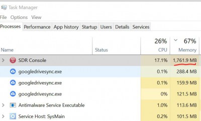

This is another tentative and I got only the task manager showing the memory at 1.7 Gb !!

Re: 3.0.27 - FFT overloading GPU
**Update**
I did a complete uninstall, including manually removing the \AppData\Roaming\SDR-RADIO.com (V3) folder.
And then installed the most recent kit, 3.0.27 build 2190.
Everything seems to be working fine now, in regards to the memory leak.
I have noticed a minor bug in the "Memories" tab, but that is something else for a different thread.
I will keep testing.
